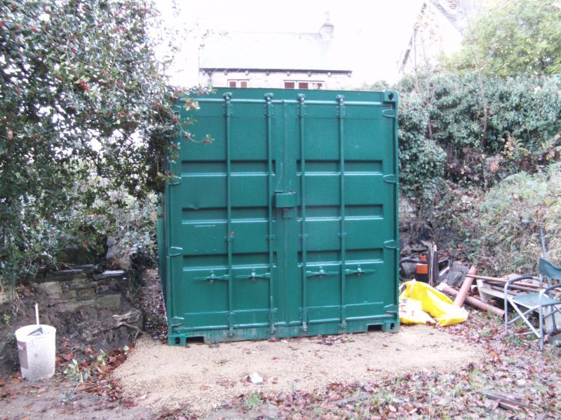

Cheers for the advice. Here is my new workshop.
I cheated a little.
I would like to put a door on the side for convenience.
Anyone done this sort of thing ?
Any advice on best way to do it ?
