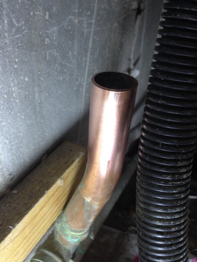

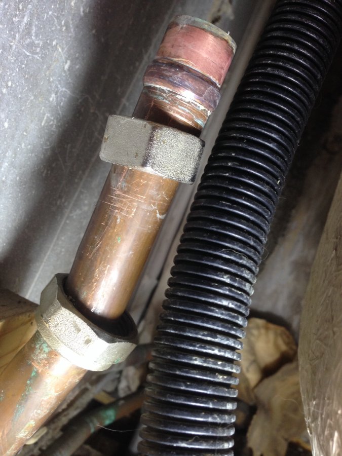

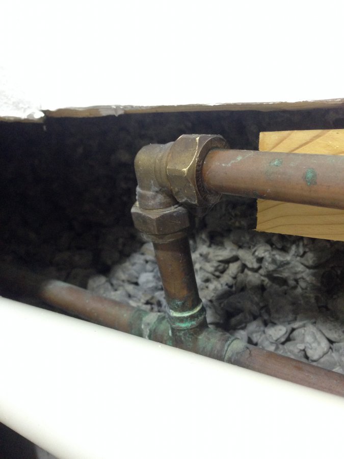

However, the pipe supplying hot water to the basin has a leak now (the major twisting jolt has obviously loosened something). I've traced it to a copper elbow joint (I think that's what it's called anyway). I turned off the water and then tried to tighten the nut. This has had some moderate success in slowing down the drip. But I'm obviously going to need to get the joint (at the very least) replaced. At the moment I am catching the drips in a shallow container.
My question is this, would some kind of putty provide a temporary fix to the leaky joint? I have an insurance policy that I think covers me for things like this. But from what I know, they are not very quick to respond. And in the meantime, I don't want to have to have my water shut off. So I was thinking I'd go to Screwfix tomorrow to get something to temporarily fix the leak. Would this product work?
http://www.screwfix.com/p/no-nonsen...yHN7GlnqJCY4TzjTjQ50esneEl1EMD13lzxoCLeHw_wcB
I'd prefer something that could be easily removed afterwards, rather than needing to cut the whole section of pipe out (the joint is very close to another joint, so there's not a lot of pipe to spare if cutting).

Any way in order to help give you a best solution for your problem, would it be possible to post a picture of the leaky joint?

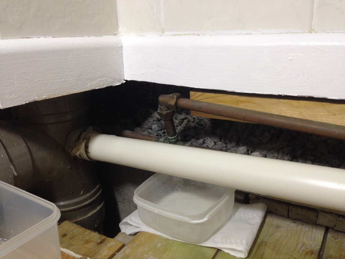

Sorry for the delay in replying. I just spent an inordinately long time trying to get an "action" shot of the drip. I finally managed to persuade myself that people on this forum would more than likely be able to imagine what a leaky joint looked like. And also, since I am half insane with tiredness - what with it being nearly 5.30am - that maybe I should just take a bloody photo and upload it! LOL! I'm not sure whether logic or exhaustion won in the end.
Anyway, I'll try to post the photos below (one "scenic" and one close-up). Unfortunately there are no isolation valves anywhere in the house....apart from the cold feed into the toilet. Unfortunately, the screwdriver slot for that particular valve faces the wall - with a gap between the pipe and wall of approx 3mm (or it did until I fixed it a couple of weeks ago - without any accidents that time).
I temporarily shut off the main stopcock under the kitchen sink earlier tonight. And my little bits of fiddling with a spanner seemed to slow the leak down when I turned the stopcock back on. If the leak was faster then I'd obviously just keep the stopcock closed. But it's manageable for now. I've gone ahead and ordered two different lots of gunk from Screwfix, the one I linked above and also this one: http://www.screwfix.com/p/fernox-ls-x-leak-sealer-50ml/23614
Hopefully that should do the trick till I can arrange a plumber (or maybe replace the joint myself? Or should I just step away from the toolbox and quit while I'm ahead? LOL!). Ok, here are the pics:

If that were me, I'd be inclined to drain the system down and replace the threaded union with a soldered one. Once you've achieved one good soldered joint, you'll want to do more!
You have a small outlay to get good materials - flux, blowtorch, heatproof mat, lead-free solder, wire wool.
The trick to a good soldered joint is cleanliness. If there is corrosion or grit in there, the joint will be poor, or if the pipe still has water in, it'll never get hot enough to properly liquify the solder.#
Nozzle
If you can turn off the hot water... unscrew the fitting and see what's wrong with it. You might be more successful wrapping extra PTFE tape around the olive and re-assembling it than you would be with an external putty type bodge.
This is how I would do it;
1. Turn off water
2. Remove compression elbow
3. Remove olives using a olive puller or if confident, a saw and pliers
4. Buy a John guest push on elbow and fit
5. Job done!
Step 4 could be , replace the olives and refit elbow but try and use copper olives instead of brass ones as these give a better seal and DON'T use any pft tape on the joint.

In view of the fact she has limited knowledge and experience with plumbing, I would keep it simple like first try and tighten that leaky joint a little more, but even a task as simple as this can result in a lot more disaster, as tightening force (torque) applied to top nut can stress other joints at the bottom, as the whole body would want to turn when you apply a force to tighten (torque) so she needs to counter act this force and do this with utmost care and not disturb the bottom soldered joint, she would need other tools like mole grip wrench to hold the elbow tightly with one hand whilst she turns the leaky nut in a clockwise direction. I hope she has a good set of open end spanners and size 24mm spanner to turn the nut and a mol grip wrench to hold the elbow and then apply counter torque to mol grip wrench and tightening force (in clockwise direction) to the leaky nut.
If this still does not stop the drips, then she would be better taking other routes mentioned above, yes replace the olives or by trying to use PTF plumbing tape, by undoing the elbow after switching and draining all the water off, to do this close mains stopcock, open kitchen tap, cold or hot tap will depend what this pipe was for, if it was for cold water then open kitchen cold water tap, as well as the bath sink cold water tap for water to escape and drain from the kitchen sink, leaving the bath sink tap open will allow all the water to drain as there would be no water retained as the air gets sucked in through the bath sink open tap.
open the elbow nut, draw the pipe out, examine the olive ring, and first try and wrap some plumbing PTF tape over it in a clockwise direction, around say 5 to 10 turns, and refit the nut, and start tightening gently, once fully tightened, switch water back on, close all open taps, and check for any further leaks.
Does that connection into the soil pipe look a bit dodgy and as if it's been dolloped with silicone sealant??
A problem I have experienced with olives is :- If you push the pipe right home, then the olive , when you tighten the back nut, the olive bites in where it is and does not move down the pipe to seal against the cone bit of the union. Some times just removing the whole pipe and filing 1mm or less of the end of it, allows to olive to seal before the pipe end hits its end stop. Sounds a bit like that with this one.

Thank you hugely for all of the helpful advice. As Mike highlighted though, I'm probably too much of a novice to attempt an "real" plumbing repairs. In the end I bought a new adjustable wrench and tried tightening the nut without trying anything else. This (which I did reeeeeeally carefully and slowly! LOL!) had moderately good success. The joint was only very slightly oozing by the time I'd finished - rather than any noticeable drip. I then was able to clean and dry the joint in order to apply some gungy stuff around the outside of the joint. This cured overnight and has temporarily addressed the problem.
The waste pipe is definitely dodgy. I checked through the photos I'd taken prior to starting work in the bathroom, and the connection seems as loose and yucky looking "pre-sink-collapse-event" as it does now. However, I notice that there is an alarming amount of movement in the waste pipe. It seems to be freely able to move in and out of the large vertical soil pipe - so that must have happened during the mishap? I haven't noticed any leaks from the connection - and no yucky smells either. So I might just leave it for the time being until I can sort out what to do about the whole lot.

That waste pipe sounds like it's just push fitted into the soil stack - it looks like someone used silicone to join it but silicone doesn't stick to plastic very well - it may be sealed with putty/plumbers mait etc. but alternatively it could just be gunge/crap etc. that are making a seal...anyhow I believe it should be a solvent weld (actual plumbers can probably advise), as such you need to disconnect (yuck) clean both surfaces to be joined and use something like polyweld to rejoin.

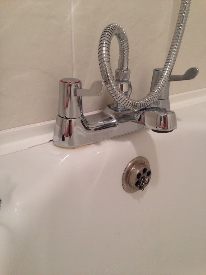

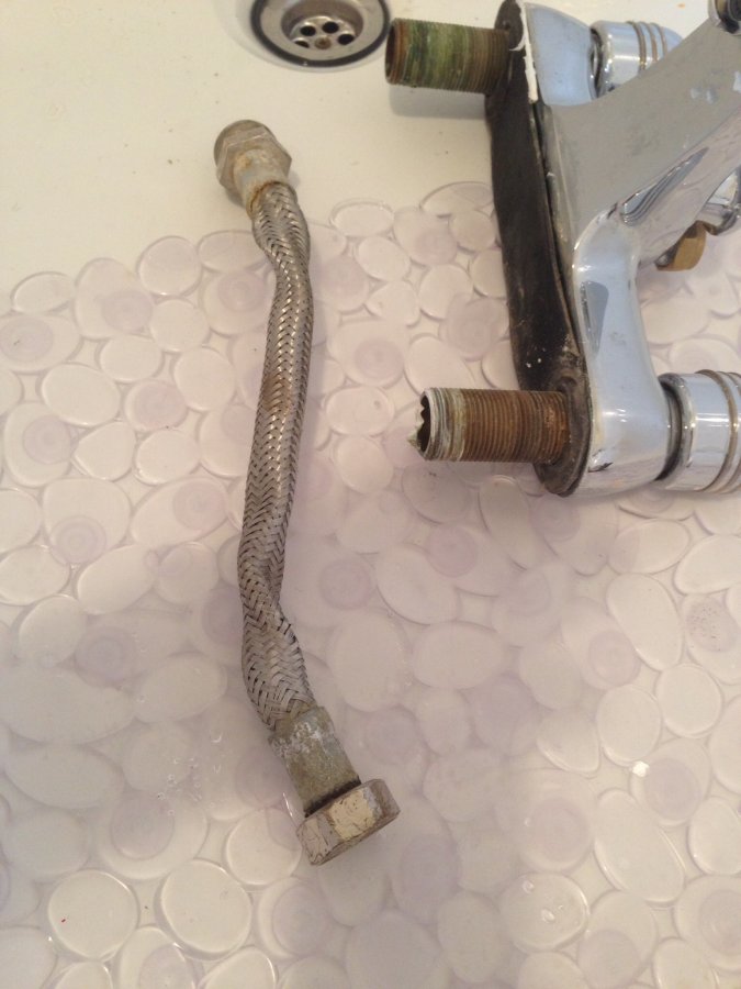

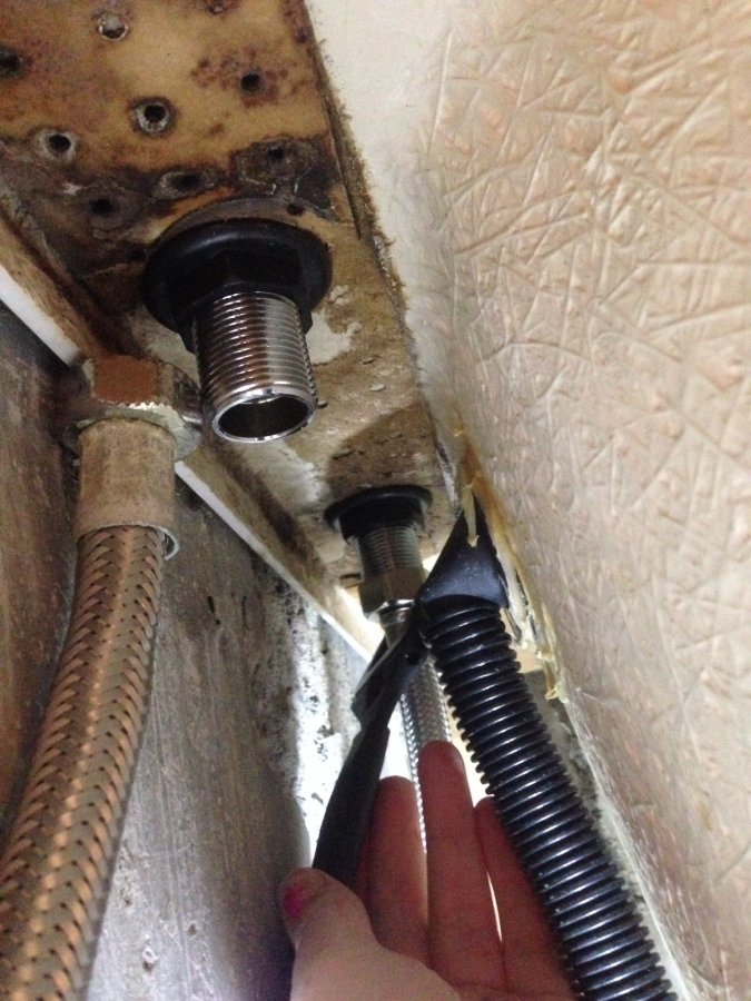

Guess what?! I took a brave pill and decided to replace the bath shower/mixer tap with a new one (I'd previously purchased the taps in October, but my plumber let me down. And I ended up just doing a workaround repair to get my shower temporarily working until I could get someone in to replace the taps). I had watched so many You Tube videos that I felt moderately confident about success.
It was a bit of a nightmare getting the old taps and flexible hoses removed - and I ended up having to cut off a section of pipe rather than break my back trying to loosen the seized up joint. In the end it was a really great experience. And it's given me the confidence to do some more upgrading within the rest of the bathroom (including cutting out and replacing the leaky joint that started this whole thread). I'm really grateful to everyone for your advice!
Here are some photos of my work-in-progress and final result:
I think you are having us on, you are a proper plumber! you were testing us weren't you!(y)
BTW, I note you have two nuts in that picture No 1
