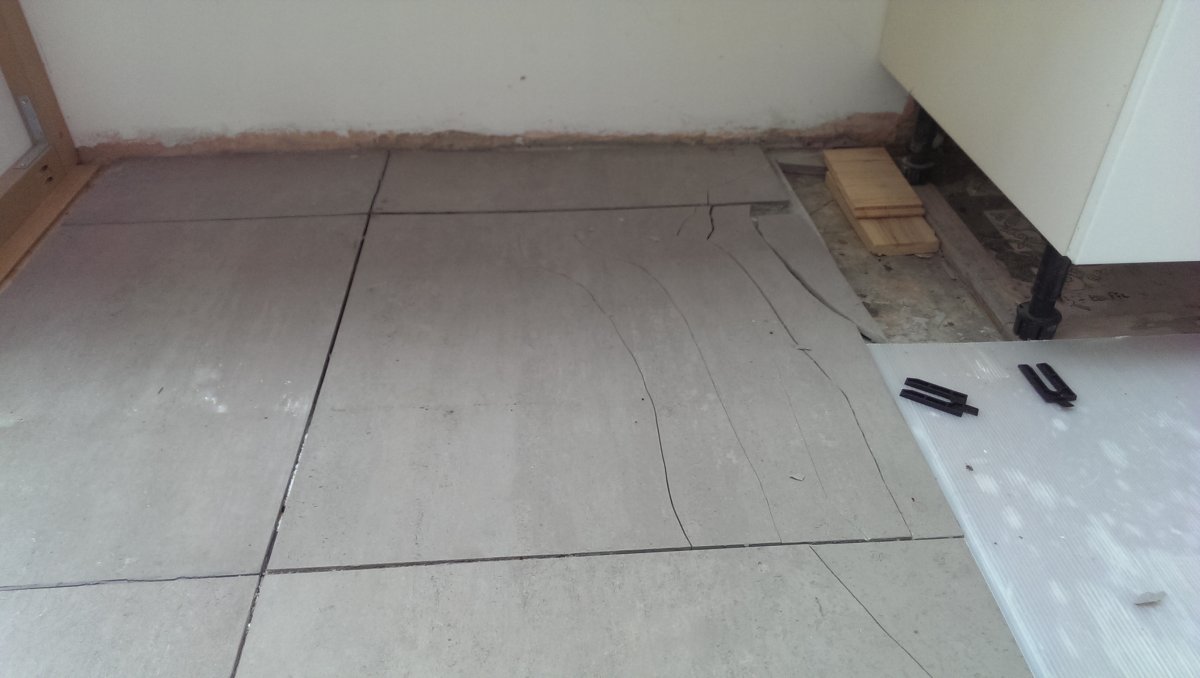

Sorry for the long post but i'm in the middle of a tiling a disaster on my kitchen floor. The kitchen is in a 1970's extension with a concrete slab floor. I removed two layers of different lino before levelling it with Bostik Cempolay deep after priming with acrylic primer. The SLC was varying in thickness from about 35mm to 10mm.
Over this I laid 60x60 porcelain tiles which looked fab for around 2 days before before I could see them starting to lift up in the corner of the room. After a month or so patch about 2m2 had started cracking and lifting. In the end I bit the bullet and pulled up the offending area to find that the SLC had completely delaminated from the concrete.
After pulling up all the loose SLC I cleaned and reprimed the area with SBR and relevelled it to match up with the surrounding sound areas, this time in two goes each half thickness. After leaving it for about 3 weeks I noticed it starting to crack in roughly the same area and after about a month again it had completely buckled and delaminated again.
So having wasted a few hundred pounds of materials and hours of my life I had to rip up the failed SLC again and scratch my head as to what to do. I've checked the concrete, there are a few small cracks maybe 2mm across but none of them have any vertical height difference and the concrete slab has been down for many years. I checked with a polythene sheet and moisture meter and there doesn't seem to be any damp coming through although I can't say for certain if the DPM is intact. There are some hollow sounding areas of the slab but no obvious signs of movement
The lino was well stuck down so in some areas there's a cream coloured residue (possibly adhesive) which is almost impossible to get rid of, although the SLC didn't really adhere to the bear concrete patches either.
I'm really at a loss as to what to do next, I've a few ideas but don't really have the heart to waste more time and money ad have to rip it up for a thid time, to make matters worse my 6 month old will be crawling soon and missus wants this sorted ASAP. My options?

it seems strange that the rest of the floor is Ok, assuming that had the lino residue over it too. you could try the tile addy direct to the floor. do a test run. or try an SLC suitable for use over asphalt. Failing that you could get a grinder on it and try and get the lino adhesive off.
How much water did you use with the Bostic Cempolay, and was it to the pack recommendations. Was the pack within date (normally only 6 months)
Having had a quick look on the Bostic website, I suspect the problems lies with the primer you used, how did you apply it.

I've heard of problems before with not using fresh Bostic, but I think it's the SBR that's caused the problem. From the pictures, the SLC went solid, but came away from the substrate, which being old tiles, has no porosity. SBR is highly rated, but I tend to avoid it as it has to be used properly.
If you check the SBR data sheet, it says key the substrate first, and then mix it with water and cement to make a slurry, but the SLC tech sheet tells you to lay it down before the SBR goes dry. If you use an acrylic primer (such as Setcrete), then you'd use it at 1:4 on a permeable surface, but neat on a non permeable one such as the tiles.

My first glance assumption is that its a moisture problem - something is causing the primer, SLC and Tile to lift & pop off. That something is usually moisture penetration.
An alternative would be mechanical pressure from the tile touching abutments with no room to expand.
Or the slab itself rising/moving due to ground pressure(s).
How do you know that you have a membrane(DPM)?
Have you seen the membrane flopped up at all kitchen walls? The same coloured sheet?
Is the kitchen FFL higher or lower than the outside ground level?
Has the kit fitting work revealed any damp in the walls?

Hi Doggit - The first time I used the acrylic primer mixed 1:4 as you say as it was painted over the exposed concrete. Second time I used the SBR, the instructions were a little bit unclear but I laid the SLC when it was still tacky.
I've contacted Bostic, not super helpful as they suggested laying a DPM and 50mm sand cement screed over the top, not exactly possible now that the kitchen is installed, also 2/3rds of the kitchen is tiled and holding on fine also the kitchen transitions into an engineered wood lounge area so I can't exactly have a 50mm step!
I suspected moisture may be the problem, there's no obvious sign of a DPM as this part of the house was built in 1974, no signs of a membrane at the walls anyway. In terms of FFL it's definately higher than ground level and no obvious signs of damp in the walls. I've laid Correx down temporarily and haven't seen any condensation build up.

I don't think moisture would cause such a problem, but you could check by taping a foot square piece of polythene to the floor for 24 hours, and see if there's any water droplets underneath it after 24 hours. But if it is moisture, then you'd need something like drybase liquid dpm, and then throw some sharp sand on it before it dries, then you vaccum the excess sand off before you apply SLC.
I would have just used the acrylic primer, and then put the SLC down, but it can still fail. I've just had to take up some tiles, and about 2 sqft of the second coat of SLC didn't hold to the primed first coat, but having lifted that section, the rest is solid.
