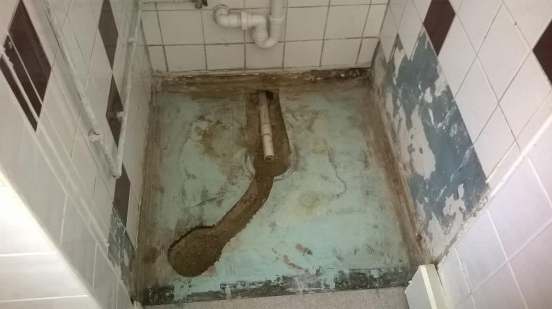

I've repaired a section of floor which use to be an old shower. I put down a base of concrete and plan to finish off with a layer of latex self leveling compound to bring it up to the level of the existing floor.

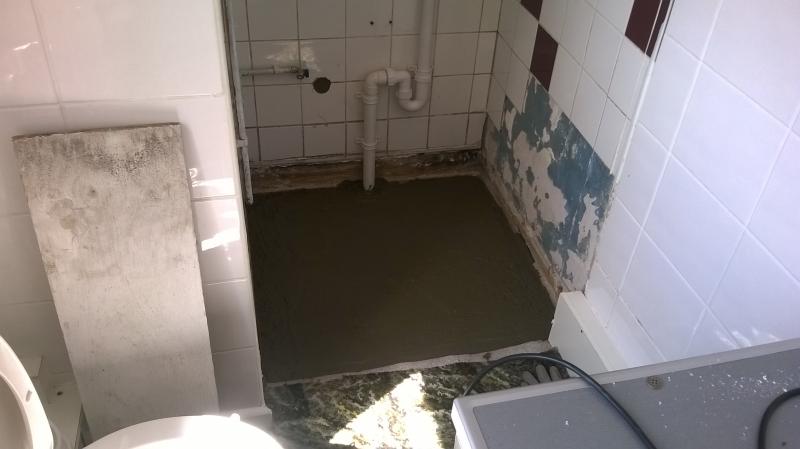

I put bin bags over the top of it and kept it moist for 3 days, I've now allowed it to dry out.
This is the before and after
I pulled out the old blue shower tray, and the shower tray that was on top of that!!
I need to to be fairly strong as the washing machine will go in there
