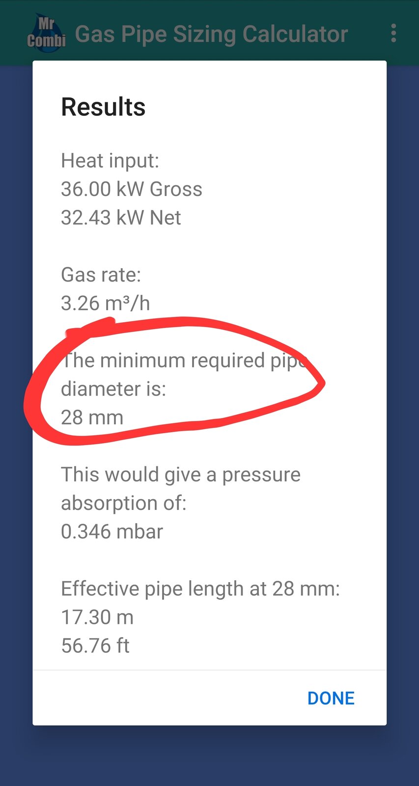

I've just had the boiler serviced and it failed due to low gas pressure.
Boiler installed in 2014 by a "mate" plumber (Gas safe registered etc), commissioning sheet states pressure was 19mb.
In 2017 we altered the kitchen, moved the gas stove by extending the gas line to it.
Gas comes in from meter (wall-mount, front of house) on 22mm copper, around a 13m run through the house/loft into the kitchen with maybe 6-8 bends and then T's off to boiler and stove respectively.
Pressure at the boiler - a Bosh 28i Junior - was apparently 18mb, when the stove burners were turned on it dropped to 16.
The chap who serviced it last said it would take another 23m of copper 28mm running around the house which will a) look ugly b) cost an additional £600 (£350 in copper alone)

1. Could it be that the meter is is not allowing the flow it should and therefor a drop in pressure.
2. The initial install in 2014 was not commissioned correctly or "flexibility" was used in measuring the gas pressure?

It could well be a meter regulator fault, however even if there was a regulator fault your pipe is still undersized according to my gas pipe sizing calculator, so it needs upgrading anyway.
Assuming 8kW for a standard gas hob, that brings your total to 36kW....
Which results in a calculation requiring the minimum size to be 28mm
Thanks Andrew. That aligns with what the chap was saying last night. "first 3 lengths need to be 28mm".
Ho hum, I guess it was dodge from the word go :(
Thanks for the help
