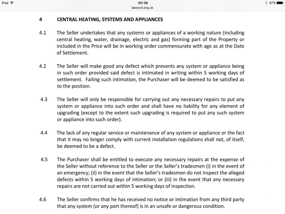

Yes Scottish house contracts do include terms like this. Something like £17,000 was retained when I bought my flat to cover work to the roof that the seller should have done! That was based on an estimate by a surveyor, but when the actual cost was much less the balance was returned to the seller.
Take your solicitor's advice, not what random strangers on the internet tell you.
Personally I'd offer them £100 off. If they don't agree, say "you get it done and send me the bill" (which your solicitor will handle for you, by retaining an amount to cover it). They will be obliged to do this in a reasonably economic way - perhaps not by getting 3 quotes and choosing the lowest, but certainly the respective solicitors will tell them they can't be unreasonable.
I wouldn't try arguing that the "in working order" terms don't cover this, beacuse at least the first item on your list is reasonably serious.
Is it the case that only houses in perfect order can be sold in Scotland?
You can buy or sell anything, but there are standard contract clauses that conveyancing solicitors use unless you instruct them otherwise: http://www.lawscot.org.uk/rules-and...ce-and-information/scottish-standard-clauses/
This is from the "client guide" on that page:
Apart from the possibility of a plastic pipe, I don't think that the lack of an earth connection to the water supply could be considered "commensurate with age" or "lack of maintenance" for a property built in 1980. Some of the other points are more dubious but this one makes me think that something will have to be done. Arguing point-by-point about the list of defects will require that he gets his own equally-qualified electrician to do a report, and that could cost more than just fixing everything - or offering a small discount.
