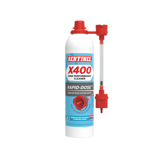

Why bother with the chance of air locks and fecking around in the loft ,just squirt this product directly into a ground floor radiator.
https://www.sentinelprotects.com/uk...heating-systems/sentinel-x400-system-restorer
Other products are available.
