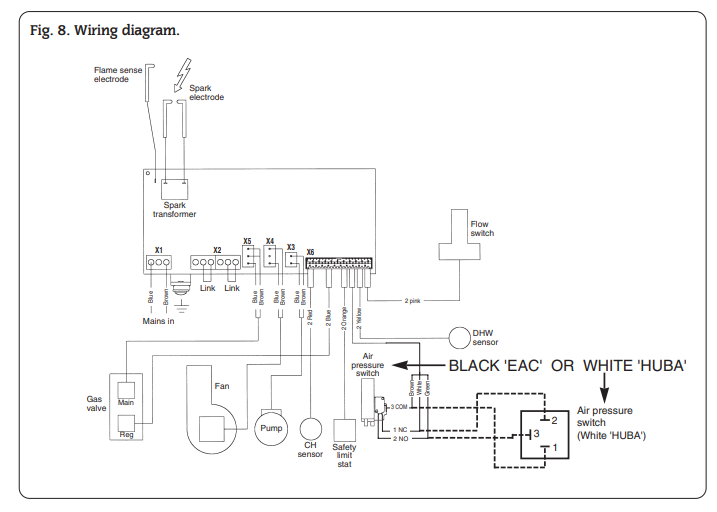

Here's the diagram. The board that controls CH & HW is powered off by the stat/timer, so it can't see any HW flow to warm up. Then if it's on, it does both. I can't figure it out...

The inputs at the top tell the boiler what to do. But as it is combi, the HW isn't controllable per say, it heats up when a hot tap is opened.
The CH is controlled by the room stat and is seperate from the hot water, except that HW has priority.
I have the 28i version and that's how it works. Hot water works whether CH is on or off, like virtually all combi's.

Apart for a couple of confusing references to the room stat, the system behaves the way the wiring diagram says, with no separation of CH and HW control. The wiring diagram shows the transformer for the controller board, gas valve, fan, everything being powered from the one source (X2 connector). And the X2 connector is little more than a bigged-up terminal block...
Wondered if there was some sort of mis-print in the manual, or if anyone had got over this issue. I have this idea to put an additional flow switch outside the boiler on the cold DHW feed, with maybe a short run-on timer. I can use some volt-free contacts and wire this in parallel with a new timer/stat and into X2. That way, the CH can be controlled by something more 21st century and any HW tap can fire up the boiler any time from whatever it is doing.

Is there a room thermostat and controller installed anywhere? Are there links in X2 between 2&3 and 5&6.

The hot water flow is simply detected by a simple flow switch and the boiler fires up.
You have posted a functional flow diagram but it doesn't say for what. Could just be the CH
This is the wiring diagram, water flow is detected by the flow switch and the boiler heats the water to the hot taps. Wheather the CH is on or off.

There is absolutely no need, there is nothing wrong that is exactly how the boiler works as @denso13 has explained to you correctly twice
