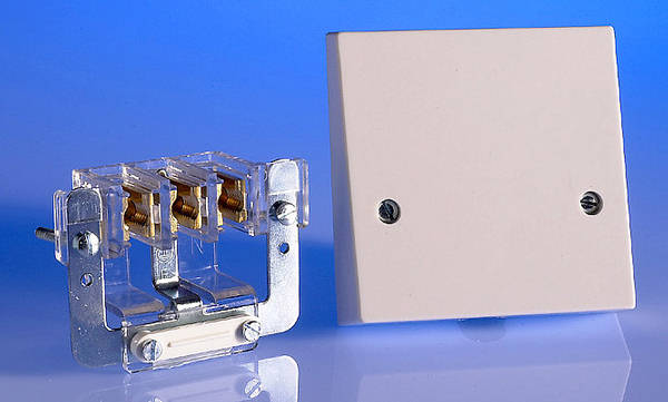

Does anyone else have problems with these terminal types. i.e. instead of clamping the cable, the split threads spread and then the brass grub screw just spins ??
Yup. Not on cooker units, but certainly on lower rated junction boxes. I never use JB's with a rating below 20A for that very reason.
I don't have a problem, but then I don't buy cheap c*appy jb's (not having a go!!) which usually are white, made in China and have nipples on the end of the screws (I shall leave myself open to whatever you lot want to chuck at me!!)
BG are good enough for me.
