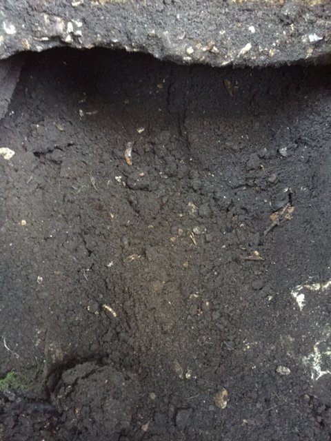

Is the "soil" in the pit a very rich loamy type - not clay for example and full of rubble rubbish etc.? It could be that it is actually soil as in the polite use of the word ( soil pipe) and it's been there so long that it has composted. with the liquid slowly seeping out the sides of the brick tank.
My thoughts entirely.....it seems a good while since the property was occupied - unless there's another tank lurking somewhere.

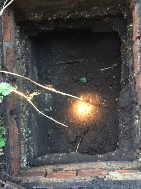

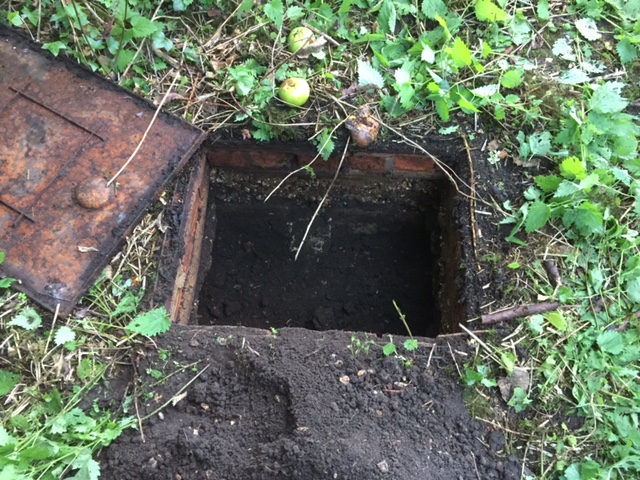

Ok thanks for the replies we are going over tomorrow to flush water down the drains unless its raining. I have tried to upload three photos to give an idea what it's like, we also found near the top a piece of safety glass about 8 inches by 4 inches triangle shape and some twine about 4 foot long neither which could have entered the tank through the pipework i just can't fathom it out.

The first pic just looks like an ordinary manhole cover, lifted and revealing (perhaps) a fresh water drain soakaway, full of soil wash from the drive or roof maybe?
Can you give us the size of the other two chambers......I would have expected to see a salt glaze dip pipe that takes the incoming soil, and deposits it in the depths of the first chamber.

That tank has not been used as a septic tank for years mate, it's been back filled with soil. My guess is there's a newer one somewhere on the property.

I would also agree that it does look as if it have become redundant.
