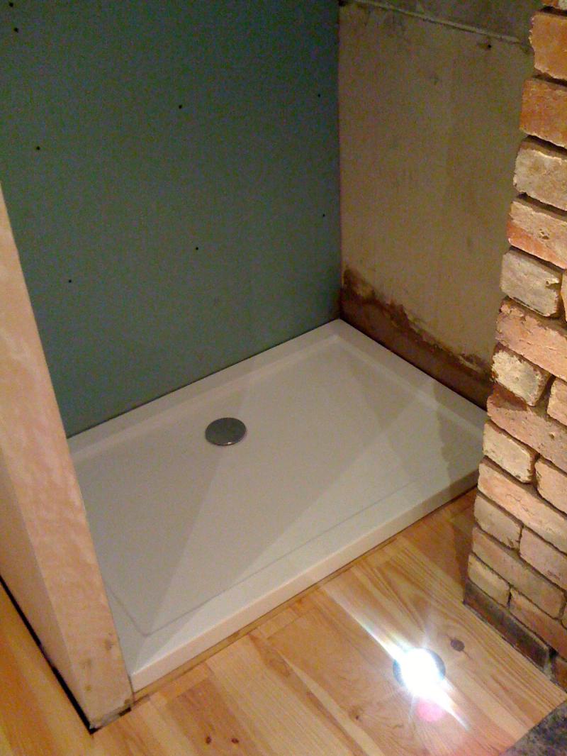

I'm fitting a 1200 x 800mm resin tray into a recess. I just want to be sure of the right sequence of events/detail, any advice greatly appreciated. The current state of the project is that the plumbing is in place, a solid timber baseboard has been fitted level over the joists. The recess has been boarded to two walls with moistureboard and the other wall is plastered masonry.
1) Unscrew the flexible compression hose from the waste. Apply silicon to bottom of waste, place rubber o seal on top of waste, then apply silicon to top of 'o'ring and position on underside of tray.
2) Tighten mushroom flange on top of tray to hand tight plus 1/4 turn. Leave for silicon to cure, then test for leaks.
3) Apply Dunlop shower waterproofing primer to all three walls, 1m high
4) Apply tape to the two vertical corners from bottom of wall to 1m high
5) Apply the waterproofing solution and wait for it to dry.
6) Mix a 5:1 cement mix and spread over baseboard.
7) Position tray over mortar ensuring it's level.
8) Reconnect waste
9) Silicon gap between walls and tray ensuring no silicon gets onto plasterboard above the level of the tray. Leave to go off.

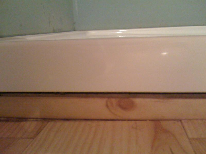

I've installed my tray on cement as advised on Saturday. The drying out process has created a small 1mm crack between the baseboard and the tray - is this normal?
The tray does seem very solid and does not move but I am worried about any cement cracking/crumbling and leaking out of the gap, should I put some silicon down this edge to seal it all in?
The tray is a slimline 40mm high tray to put the pictures in proportion. I don't want to tank it out until I know the tray is ok.
I dont follow you; whats cracked, the cement on the baseboard? the base board itself? what's it made of & how thick is it?
The base is 38mm pineboard. The cement has a 1mm crack between the tray and baseboard where is has shrunk upon drying, the tray is in tact and not moving. I don't suppose you can eliminate shrink cracking (I did not make the cement mix too wet either). I'm just worried about any of the cement crumbling and coming out of the crack in time. Should I seal this edge with some grout or silicon to prevent this?
Pine is not ideal as a base board, you should use WBP ply. Problem with pine (softwood) is it will absorb a considerable amount of water from the mortar, expand & could warp; what happens is the mortar dries hard in 24 hours but pine will continue to shrink back after as the moisture evaporates & that’s when you get cracking; using damp timber is one of the biggest causes of cracks on timber stud walls.
If it’s solid & not flexing, it should be OK as the idea is to fully support the base of the tray; you could run a bead of silicone along the edge but wait until it’s all finished as it will take a week or even longer to dry out thoroughly.
Cheers Richard. The wood was bone dry and I applied three coats of polyurethane varnish to it prior to applying the cement, so hopefully it will not have taken in any moisture. I will give it a few more days and ensure it is still solid before taking a decision to tile, gut feeling says it should be ok as long as I can seal the crack.
