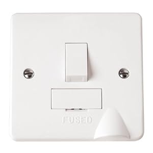

1) If you are confident and competent with electrics then dispense with the idea of having a 13amp wall socket. Go for an appliance connection plate instead.
13a DP switched connection unit
These are much lower profile. The mains cable from the TV attaches to the back of the plate. The only tricky bit is if the TV has a captive mains cable. Install and deinstall becomes a two person job.

Good call on the connection plate, Ill do that.
