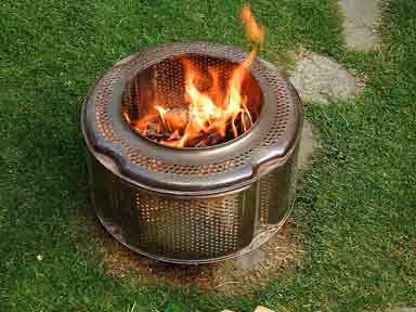

Anyway thanks for all your help everyone, I'll let you know whether it gets repaired or becomes my new 'patio heater'

Mandate, just in the nick of time!
You may have saved my machine from the fate of becoming a patio heater (shown in the picture above)

Old drums do have their uses. I used the domed back section to make a Chinese hat type cowl for a chimney pot, using strips cut from the sides and folded over to make brackets to attach it to the pot.

Thanks all, and Fido, I think you need to get out more!
