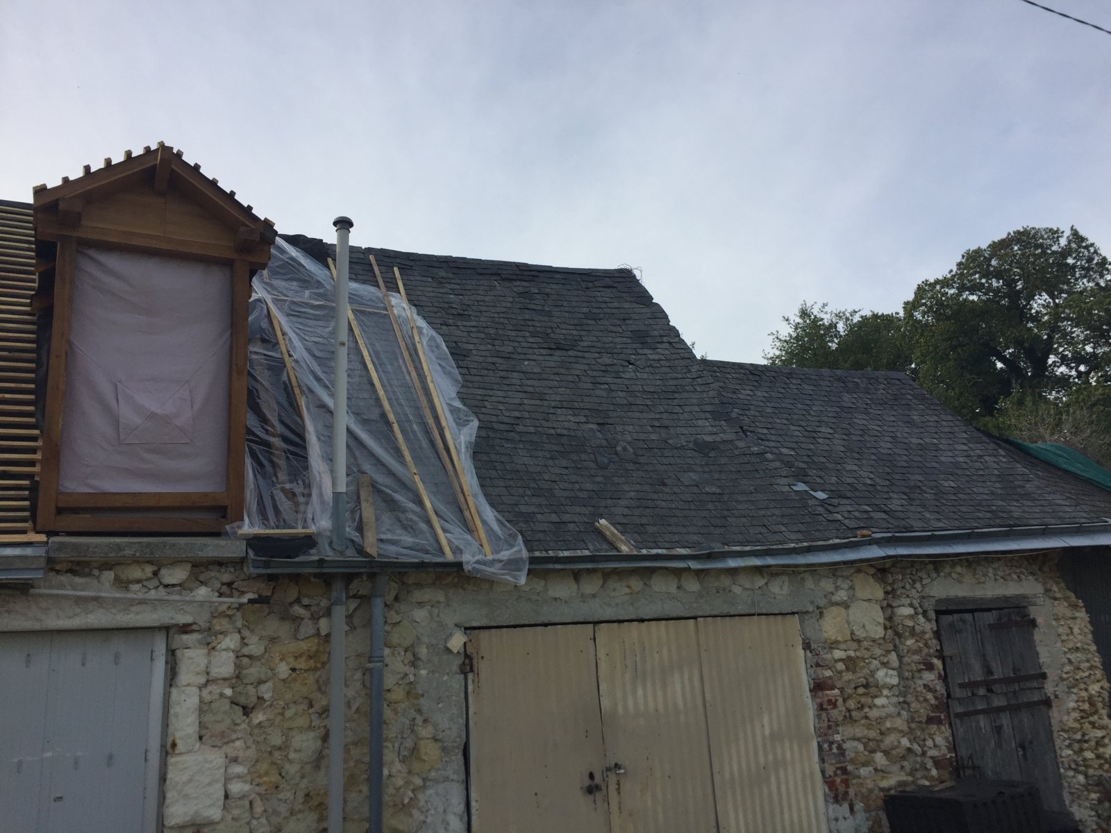

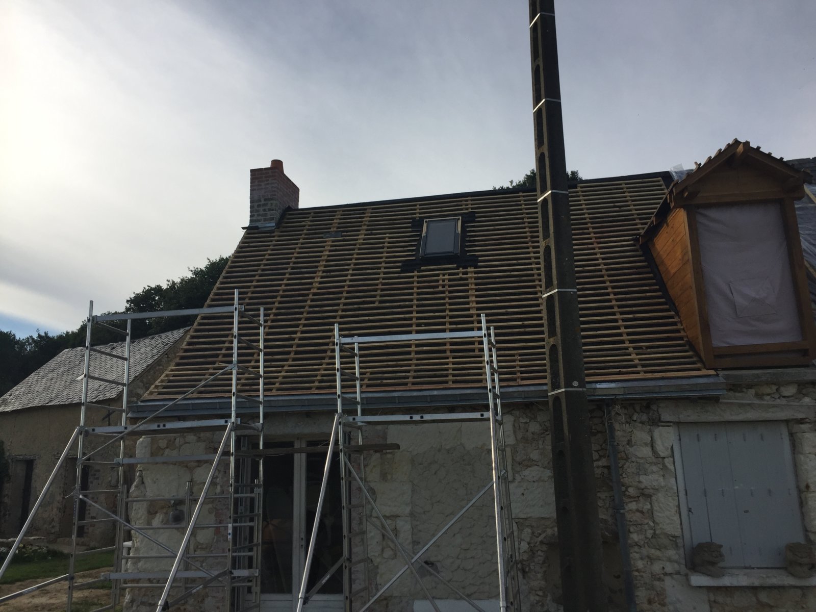

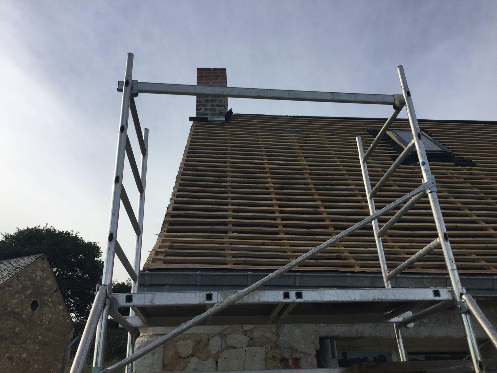

Hi Thanks for replying. It was a really old roof with lots of patches (see the right had side of the photo which I have not stripped yet) it did not have laths but had strips of uneven oak and bark almost like misshapen planks.
I have uploaded 4 photos does this give you what you need?

France I see.. Brittany by any chance? hook fix? the answer is trimming over several slates.
As above - you will definitely have to trim some slates.
But first, let the slates that you intend to trim run full length before taking a chalk line across them to mark a neat trimming line.
Do you propose replacing the fascia & guttering on the RH side?
I look at the ridge and it seems to be at two levels - I also wonder if your setting out was accurate?
Perhaps, from the "dormer ridge line", treat the RH roof plane as almost a separate roof. Presumably you want the slates to flow through & over the RH extension roof?
When the RH side is stripped - then pull stringlines (high & low) across from the dormer cheek to the RH verge - to establish a single flat roof plane.
The soil pipe vent could be forty five'd around the eaves rather than piercing the roof.
Or it could be cut to below the eaves and have an AAV if they are permitted?
Careful flashing detail will be needed where the dormer cheeks meet the sill position.

With regards to the ridge line, that was my next question as it runs out a mile what should I have done? lifted all the laths on the right hand side to get rid of the step?

Setting out with a chalk/dye line is standard practice,
There are a couple of options here, line back from the verge and trim as you go until your on the line... or cut the verge A raking cut wont hurt.
looking again from a novice angle . you may find it easier to slate back to the dormer.. there by you just cut into the dormer cheek and just a couple of courses above the dormer to join.
While it might take a little longer going left to right , It is perfectly possible.
Zinc or lead soakers, principle the same nothing to fret over.
Ridge, The gauge is set so let it run out, just as you have.
Great gutter isn't it!
Who slated the piece of roof on the right?
Thanks for you reply I will work back from the verge and trim each tile and just let the ridge run out as it currently is hopefully it will not look too bad when I get the tiles on.
