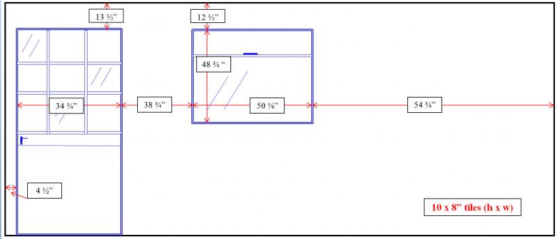

Hi guys,
About 2 years ago, I bought a new cooker and decided to tile the whole wall behind it in 10”x8(hxw) ceramic tiles.
As an afterthought, I have now decided to do the whole kitchen.
I seem to be struggling to set the wall with door & window. I need the top row to be a full tile – the bottom row doesn’t matter.
Does anyone have the time to assist me in this please ?
Many thanks

if the sink is in front of the window measure it up with the tiles centred on the window, as it is close to 6x tile size with a whole tile in the centre of the window. THat is the bit you will look at most often, then see how the other edges work out.
You also need to consider reveal depth and where tile joints will fall in the reveals.
Trail and error with pencil lines on the wall and only do it with tiles & adhesive once.

Believe it or not, I have done this dozens of times for other people,,,,,, other peoples seem so easy, but when doing your own, its different.
If I knew that I’d do it all from the beginning, I would have started with the window.
Luckily (!?) my kitchen is very narrow. The entry door from the hall is opposite the back door (in picture). Once inside the kitchen, you turn right & look down it, with the window on the left. Its not as though anyone will stand in front of it & looking directly at it,,,, but it still needs to be as ‘right’ as I can make it.
As I say, I need a full tile at the top row. The bottom row has limited viewable bits, so is less important (although the wall that I have done starts and ends with afull tile).
I think the door reveals are about 4” & the window 3”.
I have already started measuring & marking the wall,,,,, but I can't just get it to ‘sit’ right.
