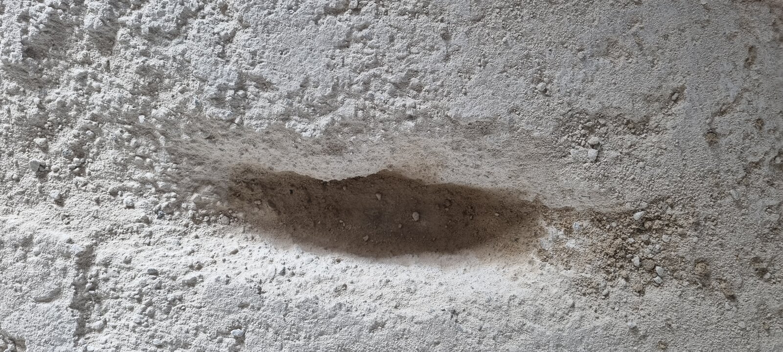

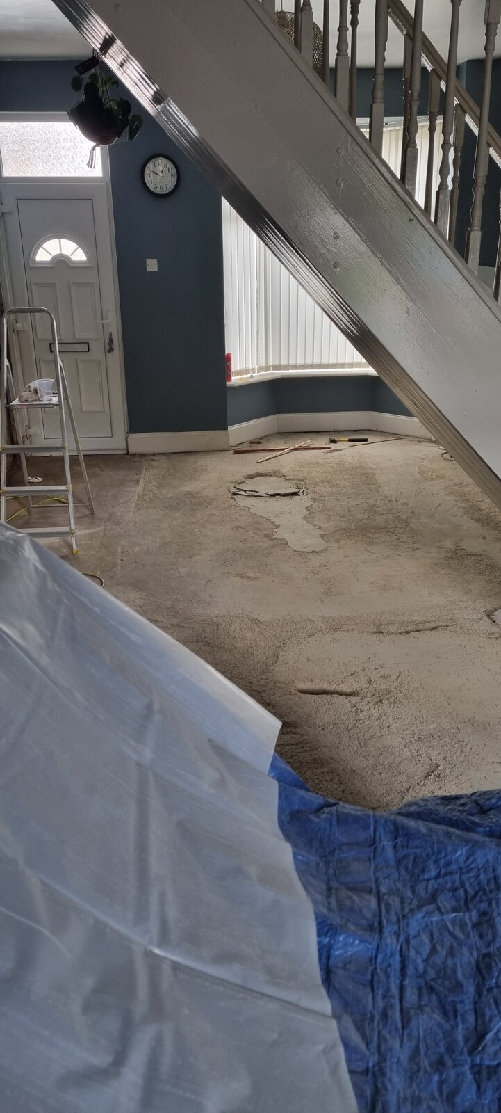

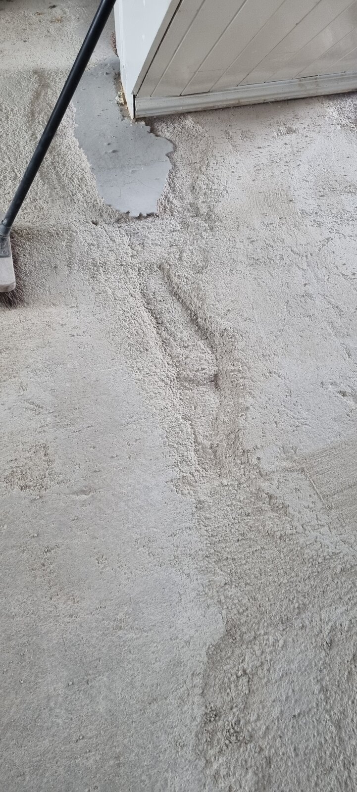

Hi,

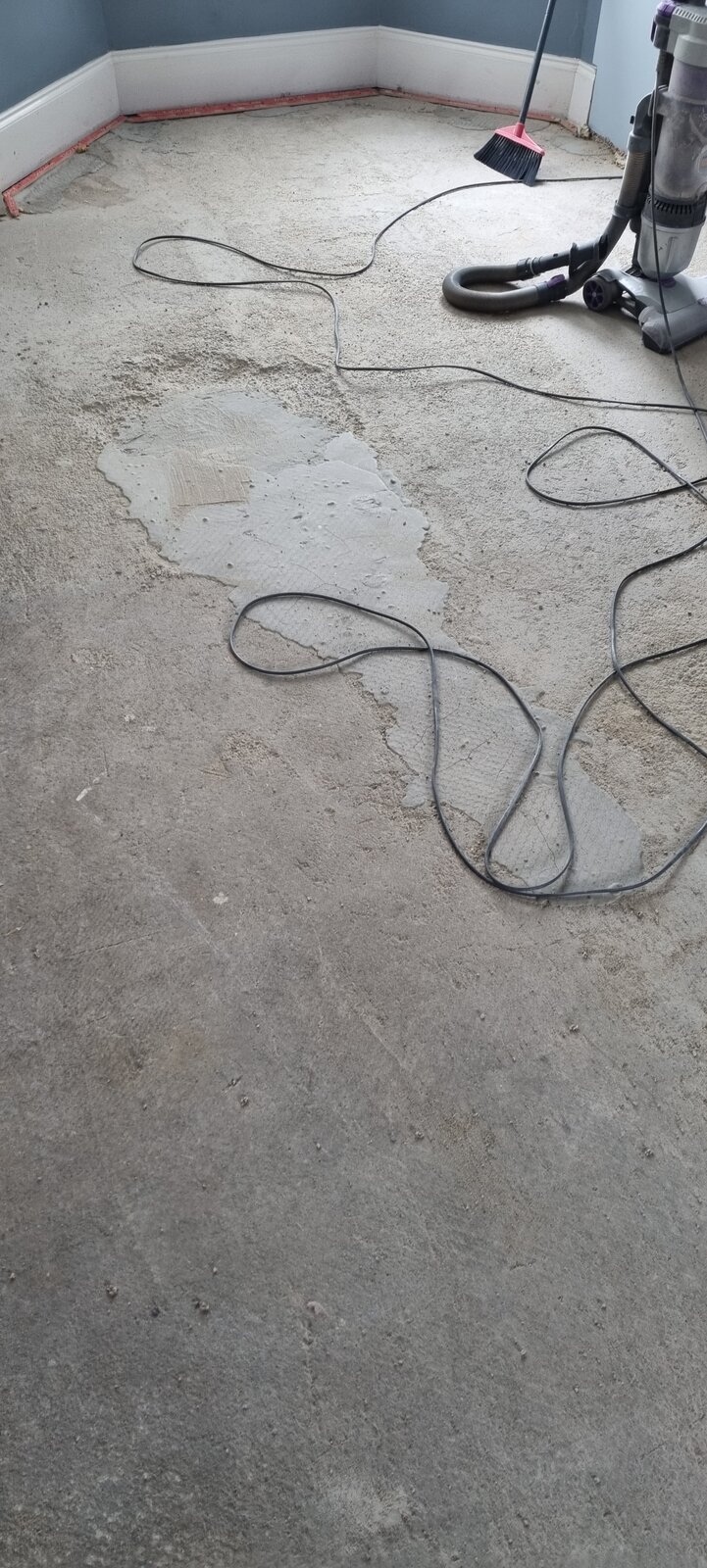

After a recent damp survey that found dry rot along a single living/dining room wall, I have taken of the plaster/mortar on the walls and removed the carpet to putdown a masonry treatment. The plan was then to paint in a liquid DPM.

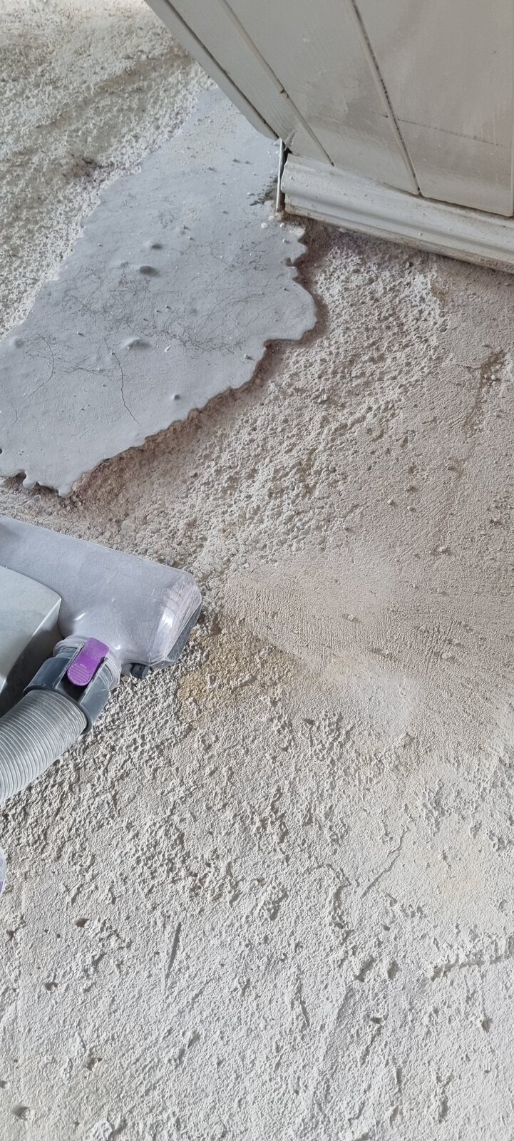

I did a quick brush followed by a hoover which is when it all went a bit grim.
The hoover was pulling up the concrete as I was going along. I switched to a stiff brush but in large areas, the brush was as bad.

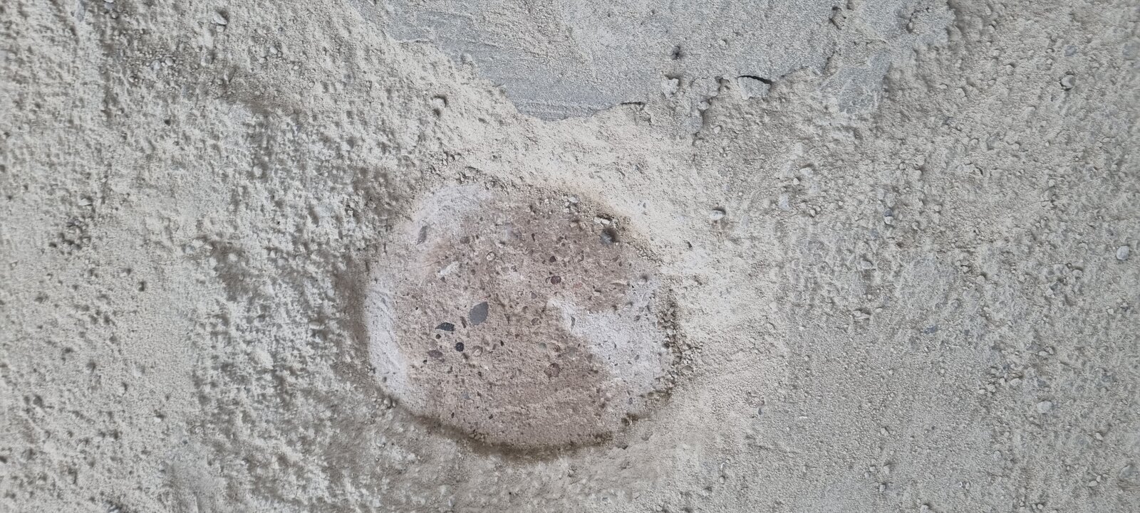

As a bit of an experiment I decided in a few places I'd see how deep i could get. After reaching > 1" I decided I need some help.

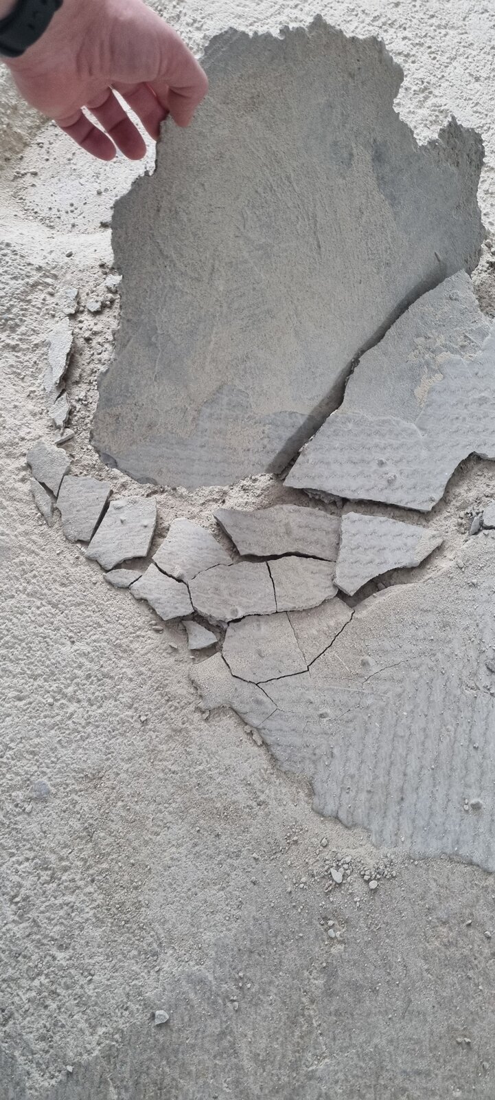

You can see floor leveller where the previous guys must have had the same problem as there are quite a few patches of it.
At the edge of the room, there were a few patches of leveller I took up (with some local concrete) and there appears to be a damp membrane under there. The damp guy said the floor was dry where he tested along the wet wall.
Anyway, we're having a baby soon and i need to fix this. It would be nice if I could clean it up but any attempts to brush it clean of dust just keep pulling more up - mortar and grit/aggregate. This seems to rule out patching it with any products known to man.
Any advice? we just spent a fortune on IVF. We cant really afford tradesmen but I am prepared to rip it all out if there is no other solution. This effects 40% of floor area 8.5M x 4.5M. One half of the room is 90% solid
Cheers in advance :)

I think you mean the surface is flaky. This is probably due to a poor mix or possibly drying too fast. Is it worse next to the wall?
Why do you want to paint on a "damp proofer?" You need to find out where the water is coming from and repair the fault.
Plaster is damaged by damp but concrete is not. You seem to mention both.

It's not worse next to the wall. I think it probably was a poor mix of the concrete. it's probably freeze/thaw damage and possibly salts. It could even be sulphite attack with the age of the house. But a guy who has had half the houses in the street had this place and the rest of the work here is nothing short of awful. Downstairs has been knocked through. Walls look like they used a Mars bar in lieu of a trowel...

Black plastic sheet in a 100 year old house indicates a replacement floor. Quite likely put down to hide water ingress without repairing the cause.
Are any airbricks visible at about floor level?
yeah air bricks visible to exterior of the house on the chimney side seem to be below floor level.
Posted some more images here as I've now raked out to hard floor level in a few places with the claw of a hammer - approx 2" and then I get a concussive shock when I whack it.
That bit seems to be sound.
The self levelling patch was fairly sound until I gently lifted one end and was essentially lying on top and not adhered. Not sure if you can make out in the wider shot but there are obvious patches of spalling/flaking. I can brush that down to the harder floor with enough patience. The other areas are fairly solid and some areas will crumble with a little more effort.

I'd be inclined to take up whatever you can lift with a club hammer and bolster.
It's not something I've done, but if you reach a firm, consolidated base, a few inches of good concrete will give you a floor.
I don't know what to do about the damp, though.
As you've found traces of old air bricks, I think there was probably persistent damp, and somebody tried to hide it by pouring concrete on top. There must be a source of the water.
A spring or underground stream is very unlikely, it's usually water escaping from a pipe or drain.
