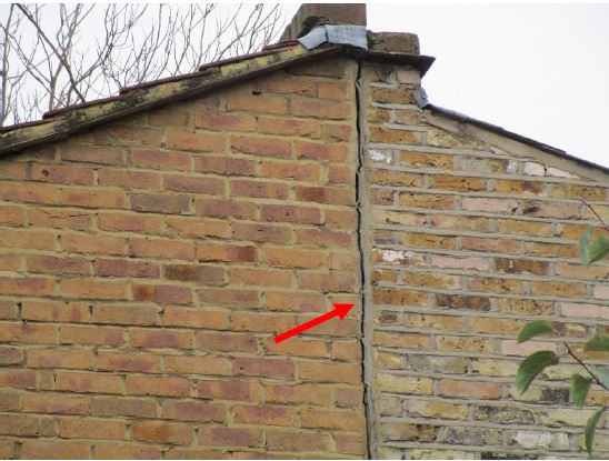

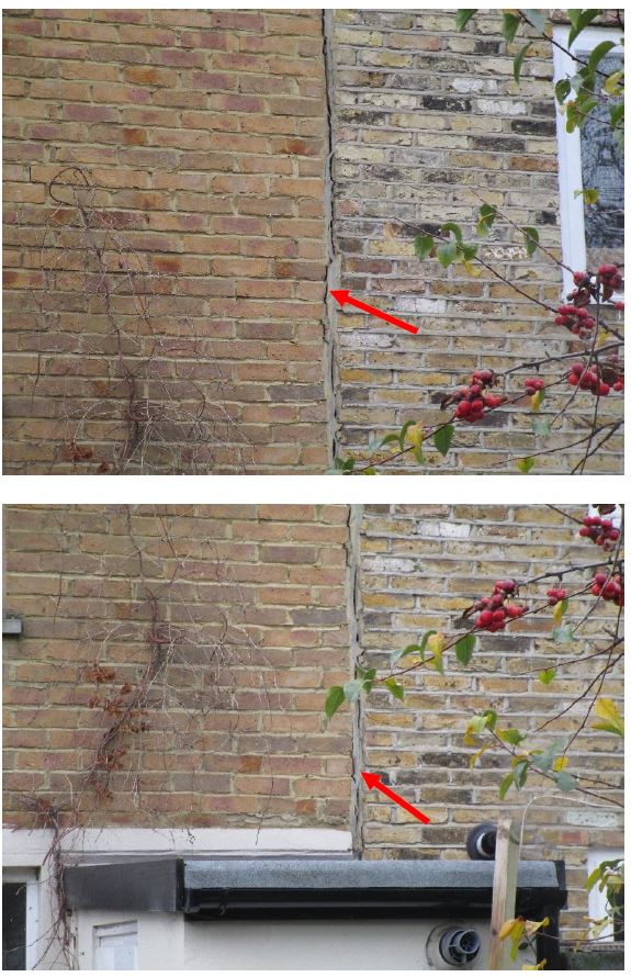

Hi,
Looking for a second opinion, as this forum is full of very good advice.
Looking at buying a property, but the surveyor has raised the following serious issue:
There is a severe vertical crack, at the abutment with the neighbouring property, on the left-hand party wall line, to the rear of the rear addition.
The area has been repointed on several previous occasions but the cracking has re-emerged.
Looking at the photos, the crack is very wide, and the movement significant on both sides.
The movement may originate from either properties. Underpinning and tying the building together will be necessary if the movement recommenced/ or is deemed progressive.
The surveyor recommends a structural engineer to understand the future repairing obligation. So sounds like the property will definitely need repairing.
I have a few questions:
Can the current vendor get their insurance to get the underpinning done? Is this even likely?
Or do I keep the same insurance provider, inform them of the structural report, and when the issue reoccurs, will the insurance provider cover the costs of underpinning/tying and I pay the excess?
Should I get the structural engineer's report with estimate of cost, and then try to negotiate with the vendor with a reduced price?
Should I just walk away without structural engineer report?
Funny thing is, both properties have just been put on the market, with the other sold STC. Bit of a coincidence, probably not. But the other property sold for very expensive price, so they would be thinking the same thing?
thanks in advance for any comments!

It looks like 2 extensions, back to back?
Judging by the brickwork, my guess one extension is much older than the other -the RH one with the birds beak pointing being older I would say.
So maybe 1 extension is done with much deeper footings than the other?
There are some Crackologists on here so Im sure one will be along with far more valuable info (y)

@Notch7 - you are correct. Two extensions- with left one finished in 2010 per council planning reports, and the one on the right existing at the time - ( no planning permission documented at council )
@KenGMac - yes it’s the party wall between two extensions of seperate properties.
So there would be two different footings for the extensions- plus the two original Victorian houses.
From your replies, the situation sounds very complicated to resolve, with both properties needing to agree before any work is done. Also, pre-inception waivers seems very risky.
Thanks for your replies...
As already stated they are 2 different building joined together with a bit of mortar. They are going to move independently. Just fill the gap with some expansion join mastic.
bit of a follow up
I had a structural engineer come and take a look. The engineer was of the opinion, that it is not a crack - but rather a gap between the two extensions. He said there has been some movement in the past history, several years ago, and most likely the other property, the end of terrace property has moved away. Just fill the gap with mastic.
