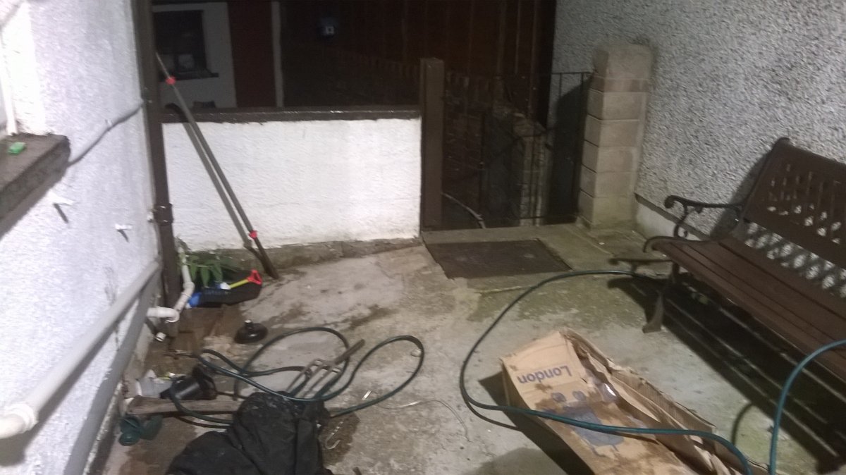

Basically my toilet waste, kitchen sink waste, shower & bathroom sink waste are all connected to the same pipe (seems stupid if you ask me) and the drain where the kitchen,shower & bathroom sink drain to has overflowed and there's toilet paper (you can guess what else) coming up through that drain. The toilet is fairly new from what I can tell and the big metal pipe that goes to the manhole in the back garden has ZERO flow of water coming out of it into the big manhole (big square drain... lol) we've tried stuffing a hose pipe down there & pouring boiling water, a coat hanger poked through the pipe... I'm really lost for ideas and we can't really afford a plumber. Does anyone else have any suggestions? Pics below.
The toilet isn't overflowing inside the house, the drain is just overflowing.
Any clues?

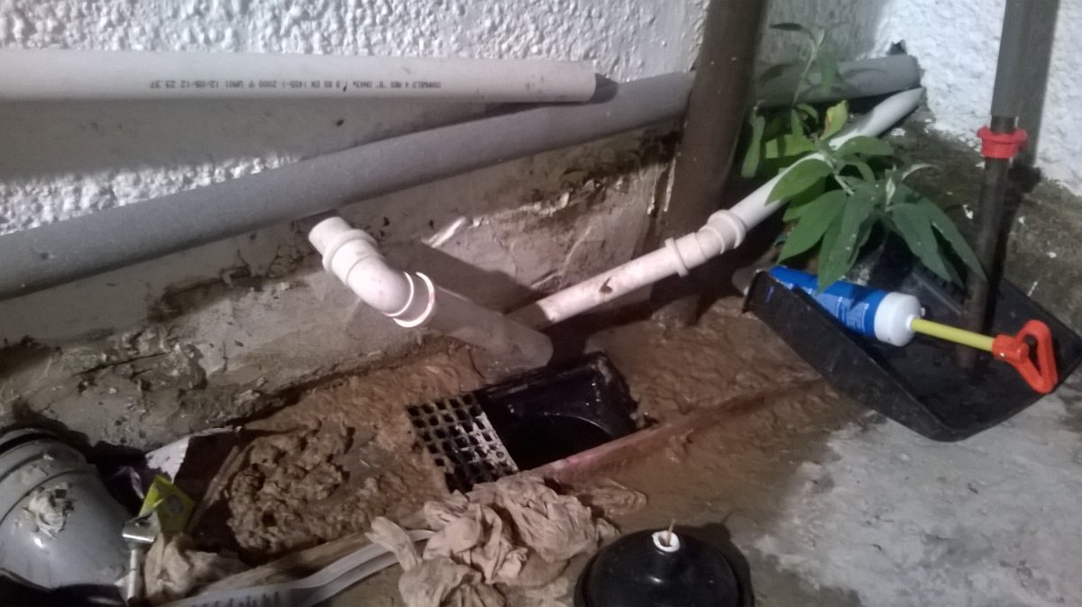

It sounds like an underground blockage but I'd question how the new toilet has been connected - it should connect direct to the manhole, judging by the angle it may be connecting into the same run as the gully.
If it's blocked below ground then it's time for rods or jetting from the nearest manhole.
The rest of that pipework needs tidying up and connecting properly to the gully.
If that's a pile of wet/baby wipes in your picture then that's almost certainly the start of the blockage

All that clutter is obscuring the soil pipe bend, but i cant see a clean-out - there seems to be an extra pipe? A washing machine?
If you lift the manhole cover then all the drains coming into the manhole, and the main drain leading out from the manhole could be rodded from the manhole.
I suspect that the blockage is in the main drain leading out from the manhole. Can you access and open the next manhole leading out of your property? I presume that you are on mains sewage?
If either manhole is full of sewage then come back here.

Its possible that the rainwater pipe is bringing down leaf debris from the guttering? There's vegetation growing in the corner with the tangle of pipes.
Your pipework could be far better sorted - it would pay you perhaps to get a plumber in to free the drain and sort the pipework - just saying.
