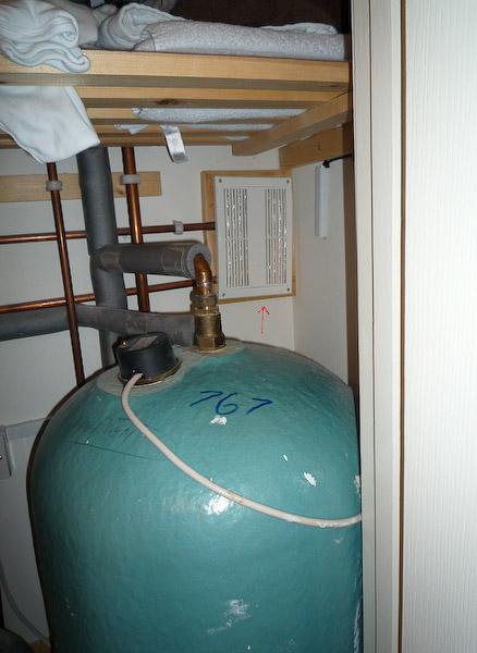

Looks like this:
http://www.screwfix.com/prods/16105...t;jsessionid=5TPKHSQIJXGMGCSTHZOCFGA?ts=53248
Has some wood supporting it off the plaster and some copper pipes going in behind the vent. I need to take it off to see what is behind it. The smell might not be coming from the vent itself. The back of the airing cupboard is a shower wall and I wondered if perhaps it was mold behind the stone tiles on the shower wall causing the smell.

Finally got some photos. Below is a view of the vent in the airing cupboard (the back of the airing cupboard is the wall of a shower in an en-suite), behind which I believe the soil pipe between the utility and en-suite runs.
A property maintenance chap being helpful covered the back of the vent with clingfilm with a view to stopping the smells but I suspect the idea of the vent is to allow air into a durgo so I presume he is doing more harm than good in adding the clingfilm.

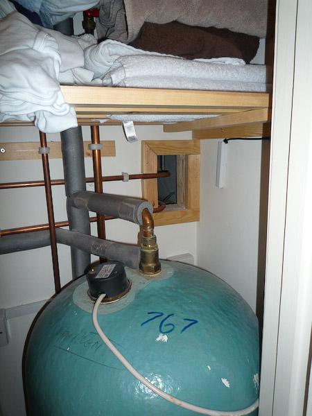

Here's the shot with the vent off:

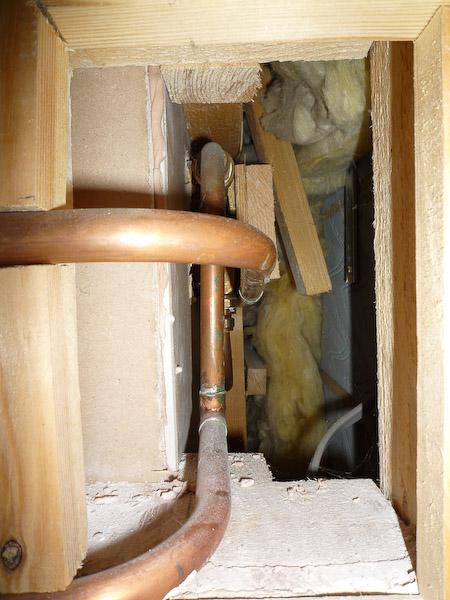

Close up into vented area showing back of shower plumbing:

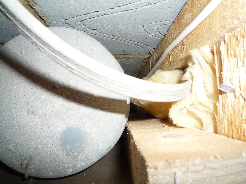

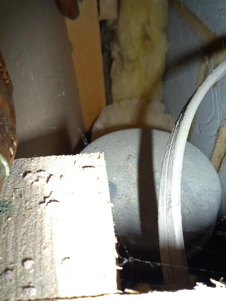

Now the interesting bit - this pic is taken with the camera pointing down into the vented area. I was expecting to see a waste pipe in that vented area going up to the loft (which is directly above the airing cupboard) but it looks like it stops behind the shower:
I presume that is a Durgo at the top of a waste pipe?
The smell coming from that vented area is pretty bad with the vent off. The smell is worse from behing our washing machine which feeds into the same waste pipe.
Any suggestions? Is that circular thing on top a durgo? Is it faulty? Help! Read about methane and explosive gasses and stuff and getting a bit paranoid now.

That should be a durgo on top. is there a way up into the roof to raise the thing into the roof void so you can get at it in future-or even take a vent through roof . Strangely, there have been a few posts about drain smells/ durgos lately. Including my house here :eek: I have one in the garage the other branch of the drain goes to normal vent, so it`s all to regs etc. BUT we get smells from another manhole when the (garage) wc is flushed. I am altering the pipework to go through the roof and making a lead slate for it (just because I can ;) ) Have a google or Ubbink vents. they make roof vents that replace tiles and connect to soil pipes. I`m beginning to think that durgos are not that clever after all :cry: You mentioned a property maintenance guy - is it a newish house, and he works for the builder?. or did you just try and find someone to fix it. You might have some redress with builder if it`s still under guarantee
