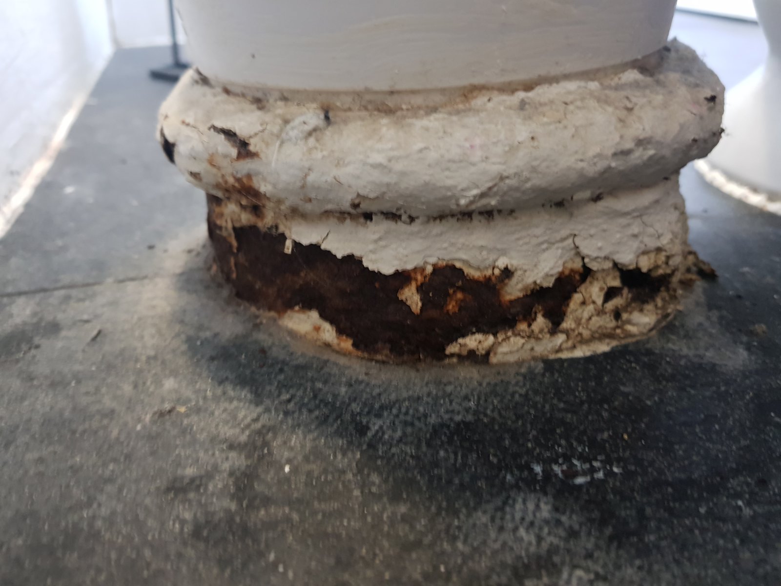

1.The toilet waste as it goes into the floor looks rusty but does not appear to be leaking.

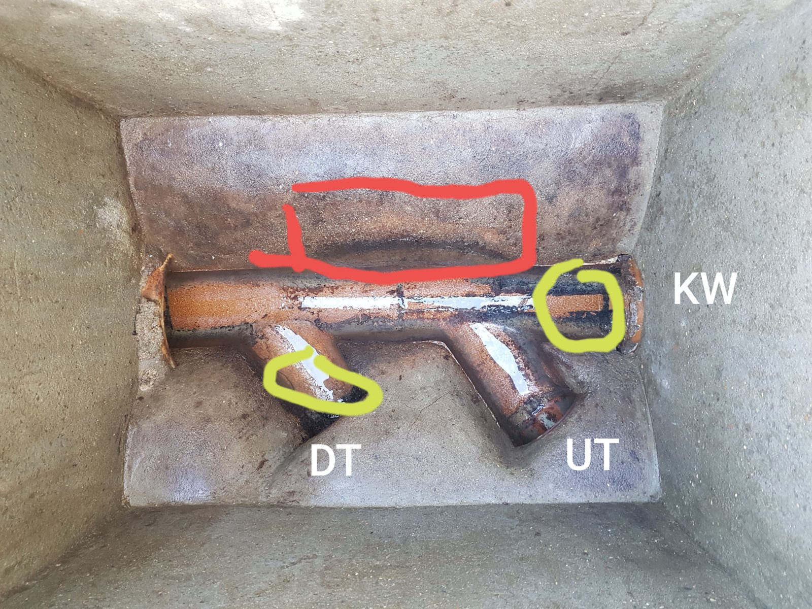

2. I checked the inspection chamber and while all looks fine, I have noticed two things,
A. When toilet waste from upstairs comes into the chamber it seems to wash up the side and often sits on the side wall.
B. Also when toilet waste from upstairs it seems to travel towards the kitchen and downstairs toilet waste, but comes back out but again sometimes sits in the channel.
Tho the chamber is not blocked and flows well.
Dodgy photoshop:
KW = kitchen waste
UT = Upstairs Toilet/ Bathroom
DT = Down stairs toilet
Red and yellow areas are where bits of waste seem to get stuck.
Anyone tell me if this is normal or point me in the right direction?

1/. Clean of the old Cast iron and have a really good look for any cracks?

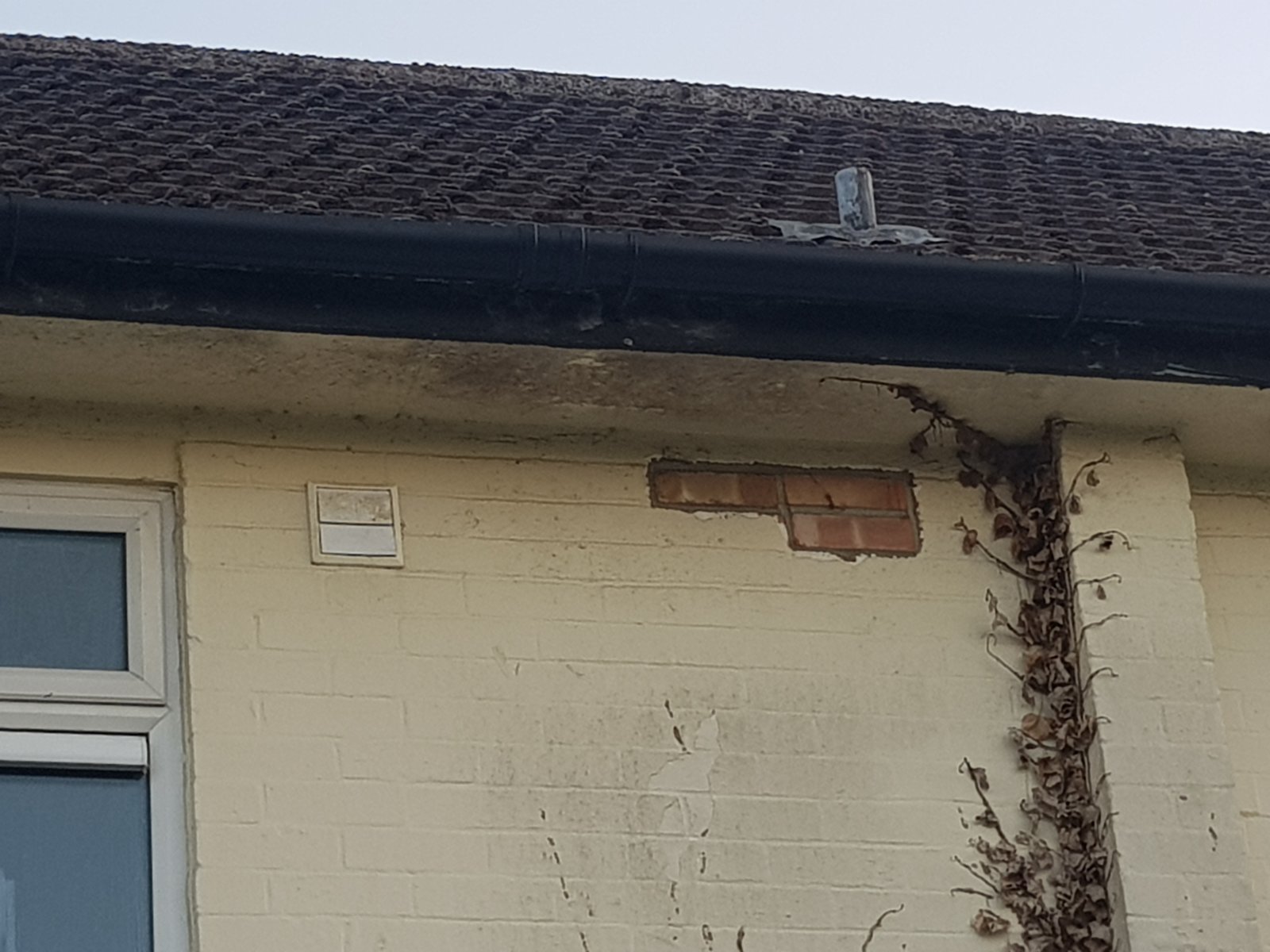

2/. Is the soil vent above both bathrooms clear and not blocked?

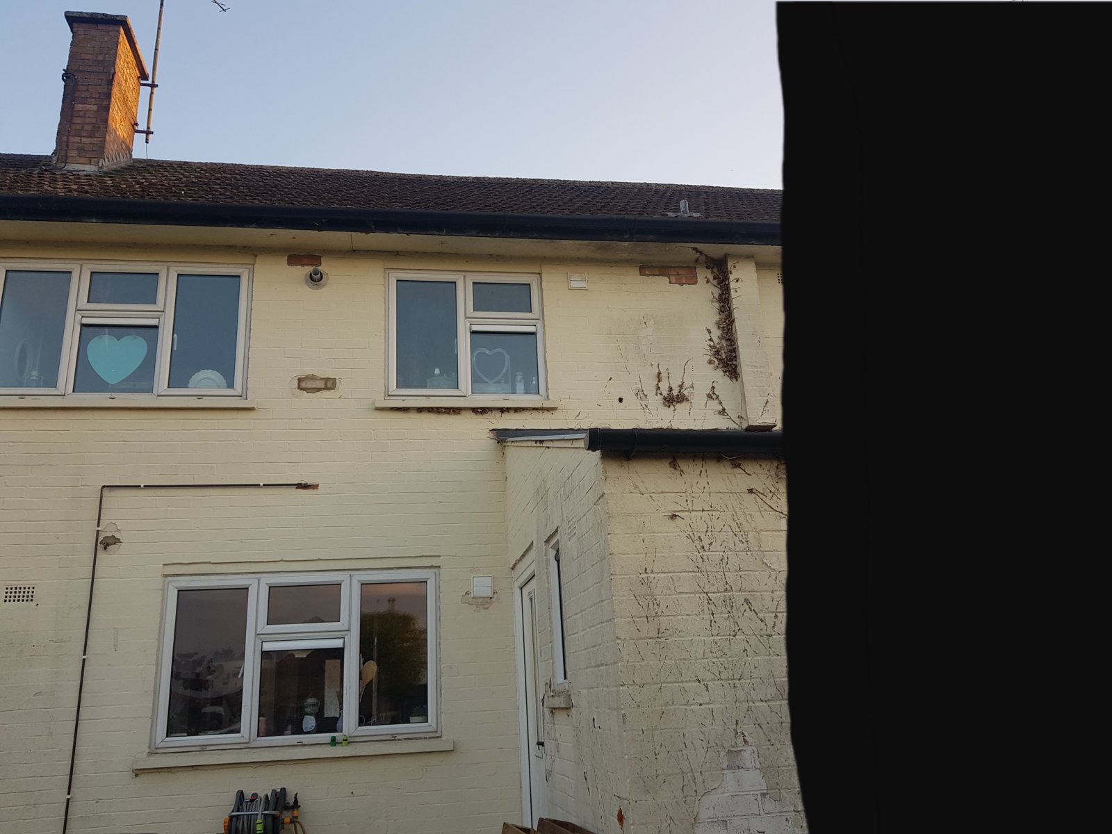

The lower toilet has no vent at all but is in like a outhouse see picture and the upstairs comes out the roof and is just a pipe so cannot see if it's clear other than from the ground?

Chamber looks clear, I wouldn't worry about that too much. From your description I would think the waste is coming into the chamber at quite a velocity, (given its falling from first floor level, also depends on distance from bottom of stack to chamber), once hitting the chamber, the pipework downstream may not be on such a steep fall, so it slows everything down. There is no standing water or build up of waste in the chamber, (as well as the physical condition), gives a good indication of a well constructed drainage system.
Yet to come across a blocked vent, again pretty sure the vent pipe is protruding through the roof and ventilating the system as it should, and given the stack can vent to atmosphere, back pressure is very unlikely. Check traps as Just Pumps has suggested, I'd also be looking at bleaching the basin overflow, crud can build up in these. Also, what is the floor made of? Wooden floors can soak up 'liquid' over time, especially is their are children in the house who aren't always careful with their aim. Lastly, (for now), have you removed the bath panel/any boxing in of pipework, to check for leaks?
