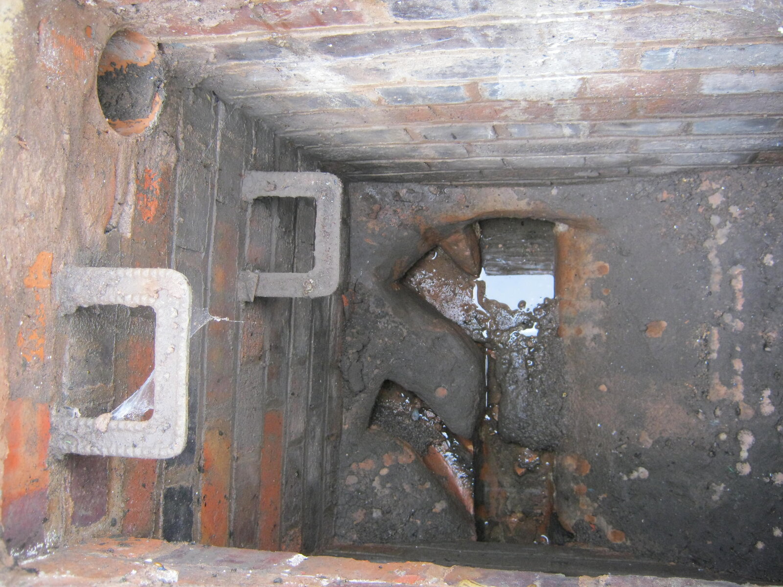

I recently had the manhole cover off my drain as there was a smell of blocked drains, turned out to be next door
But I did notice what looks like a small blockage at the bottom, it almost looks like cement / concrete
I’ve never looked down a sewer so not sure what it should look like!
Also what is the pipe at the top left corner (Vent?)
Top pipe most likely a vent, if it's been capped off at the other end, you can do the same in the chamber. Stuff a plastic or paper bag up it, and fill flush with concrete. (Don't drop any down the chamber though!)
You are right in saying the detritus in the channel shouldn't be there, could be cement/concrete or possibly scale. If you try and break it up, either remove the pieces as you go or break it up into pieces small enough to wash through or you'll soon have another issue downstream.....
If its a shared drain it may fall under the responsibility of the local water company. Give them a ring...

where would the pipe vent to, Back to the stench pipe on the outside of the house?
the drain is only about 12ft from the property
As it seems so shallow could it have been damaged when the patio was dug up, an would this cause any problems?

Chances are it went to an early type of Air Admittance Valve, (similar to that discussed here: Is this a Victorian soil pipe vent? | DIYnot Forums), and has probably been removed and/or buried at some point in the past. It's removal wont cause any issues other than a possible exit for rodents.
