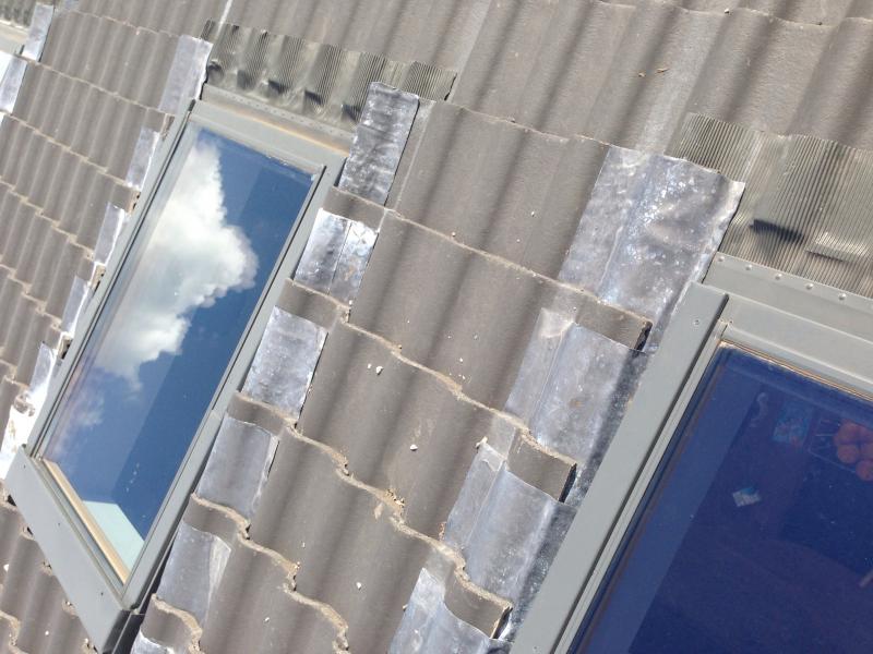

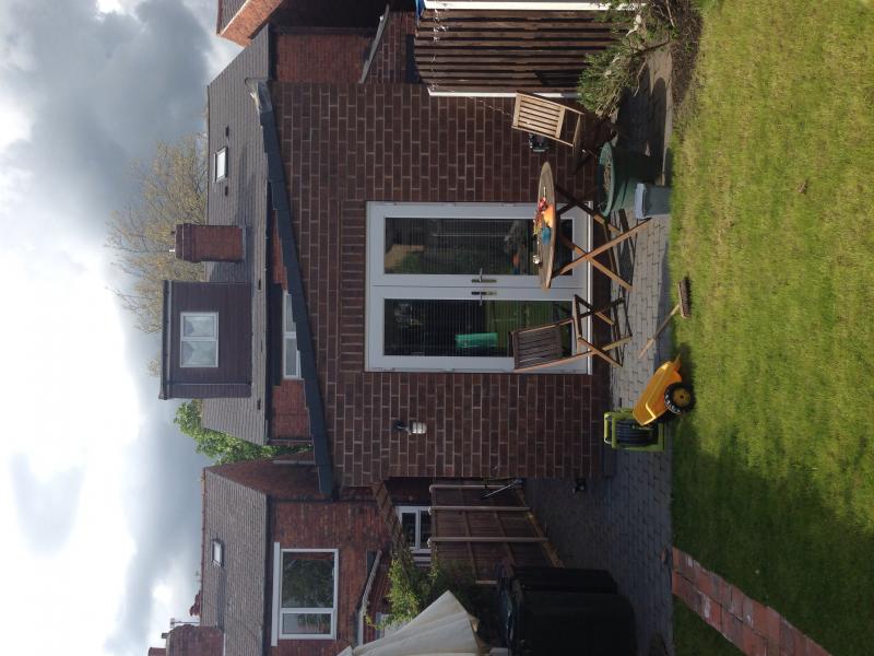

We recently had an extension built, finished six months ago.

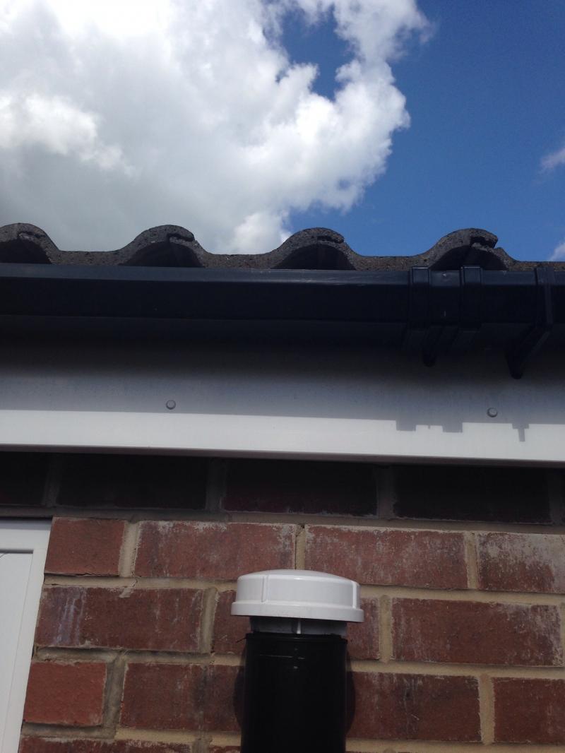

The pitch of the single story roof is 10.5 at it's shallowest, rising to 11.2 at the apex.
We have four keylite windows. Three 900mm and a smaller one.
The roof was boarded, felted and then forticrete tiles finished the job.

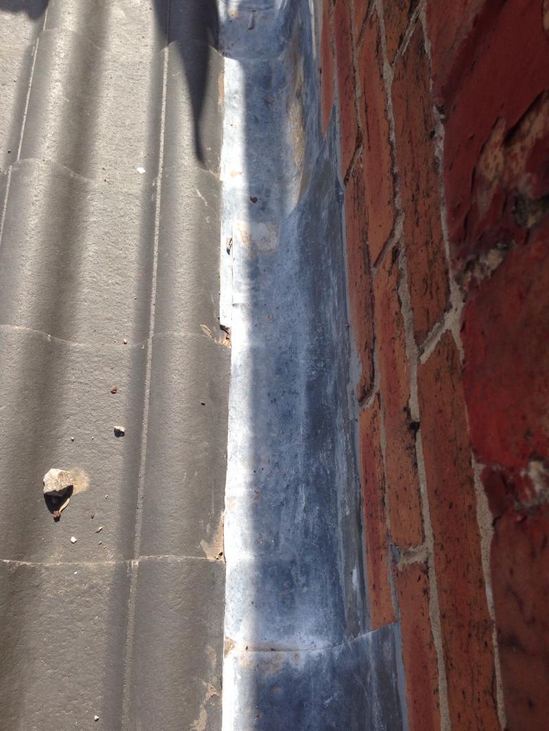

It leaks. It leaks everywhere. From the windows, at the joins to the walls and the join to the main house.

There are some tiles that officially go down to 12.5°, not sure if they officially go lower, maybe with a bigger overlap they would be OK. Your rooflights are certainly not designed for such a low pitch, they need an upstand if they are to work at that pitch. Replace with tiles at your own peril! That said it could just be down to really poor workmanship. Photos would probably help.
Otherwise as you say stick a flat roof material on instead. Zinc looks nice if you like that kind of thing.

I would have thought the building inspector would have picked up on some of those issues, and only someone with little knowledge of roofing would construct something like that.
When will people ever learn! Who designed the extension?
Did the same builder put that carbuncle on the main roof also?
May I claim innocence, please??
Carbuncle was put on by a very different cowboy. It's due replacement soon.

The majority of the work is around the roof lights and the ridge. With that in mind you're looking around £4500 plus Vat.
At very, very best you could get it just under £4k all in.
Sorry if I've just knocked the wind out of you......
Zinc is fitted with a lifetime guarantee not that it helps with the bill but it is a "fit and forget" product. :mrgreen:

So you thought you would build an extension then design it after it was built?
Zero design. Zero building control. Clueless madness.
