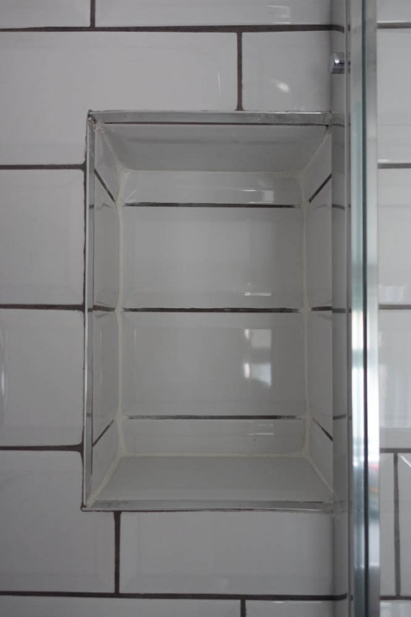

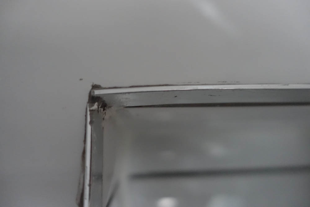

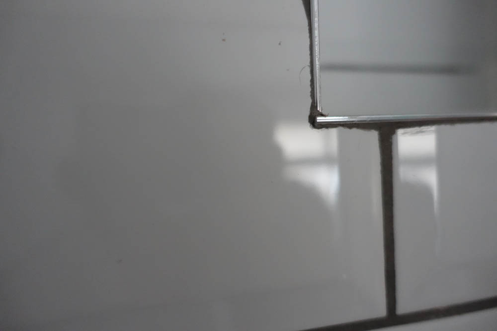

I recently had my bathroom tiled. The tiler used a metal edging, but it's left sharp corners on the recessed shelves. Is it possible to file these down?

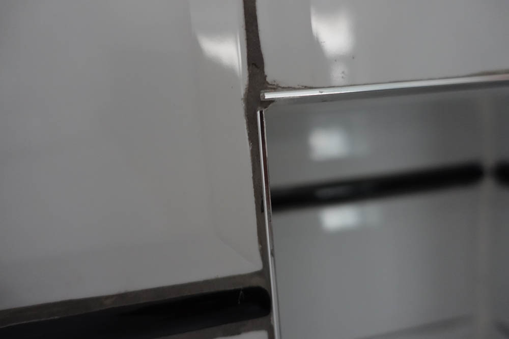

Also, he's used big blobs of adhesive under each tile, leaving cavities around the edges. I know this is sealed with grout, but could it lead to problems with water getting in? If the grout cracks, and water gets behind the tiles, there's plenty of space for the wall to fill up with water!

Why is the grout a different colour in the soap tray !!!!!!
Mitre block could of helped with the cutting of the trim ?

and in answer to your question no he should have laid the tiles on a solid bed. As you now already know it's a poor job

If you can live without the recessed shelves - cut the tiles out / fill the hole and go over with tiles. I'm not a pro tiler but I wouldn't have tried cutting those edge trims - they're bad enough round windows:unsure:
The saga continues - I just took a tile off to see what the tiles were stuck onto. Just standard plasterboard it seems, with no waterproofing treatment at all.
This is all coming down and being done with moisture resistant plasterboard, and the tiles solidly bedded into the adhesive. Good advice Nige, I might well dispense with the recessed shelving, or at least make sure its properly tanked if I go with it

But were the tiles stuck on properly, or were there large air gaps behind the tiles like this?
It was tiled correctly.
The point I'm trying to make is, don't throw your money away redoing it all. I have removed many a tile from walls and floors that have been in place for years that were fixed on dabs.
