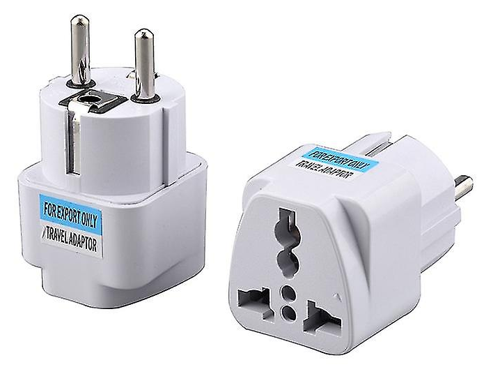

The proper adaptor
has earth connections, and also holds the euro plugs firmer, the two contact version
hold the plug even firmer, there are also versions needing a tool to remove

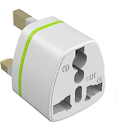

these are as under UK trading standards suppliers are not permitted to just supply adaptors, it needs to be fixed, but to fit plugs by cutting off EU type it would need training so the adaptor which requires a screw can be fitted by untrained personal but complies with UK trading laws.

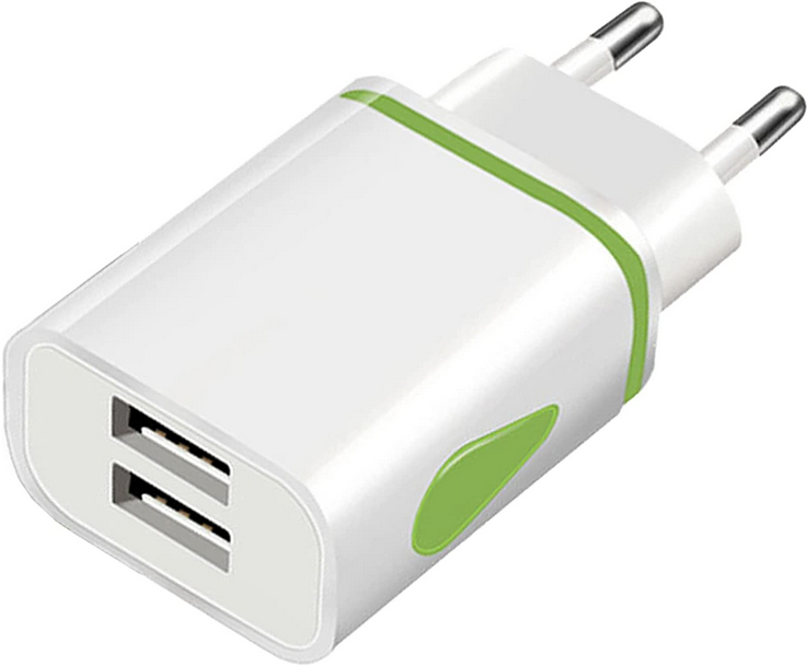

These
are dangerous, often no fuse, insulation on the earth pin, and no shutters, but these
supplied to Europe are OK as in Europe they don't have fuses in the plug, OK still no shutters, but you can understand when looking at the two how the error was made and these dangerous plugs have been manufactured.
