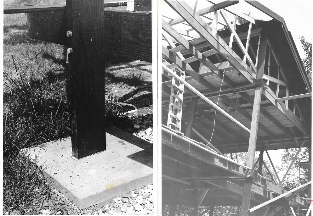

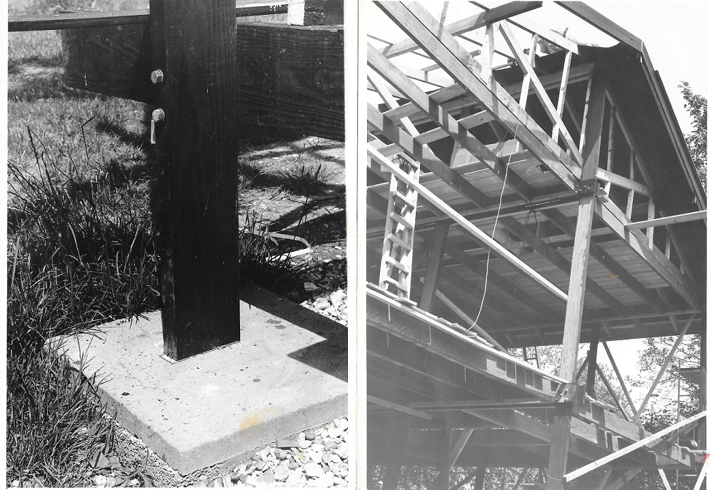

45 years ago we built this timber framed house. The 22 posts stood on paving slabs, Between the post and the slab is a piece of lead sheet which seals the end grain of the timber to prevent moisture affecting the timber. Still in good condition,
Compacting the ground could cause problems for the tree roots.
You might be better off raising the shed off the ground by a few inches, your posts can just sit on a concrete block, or 50mm paving slab.
