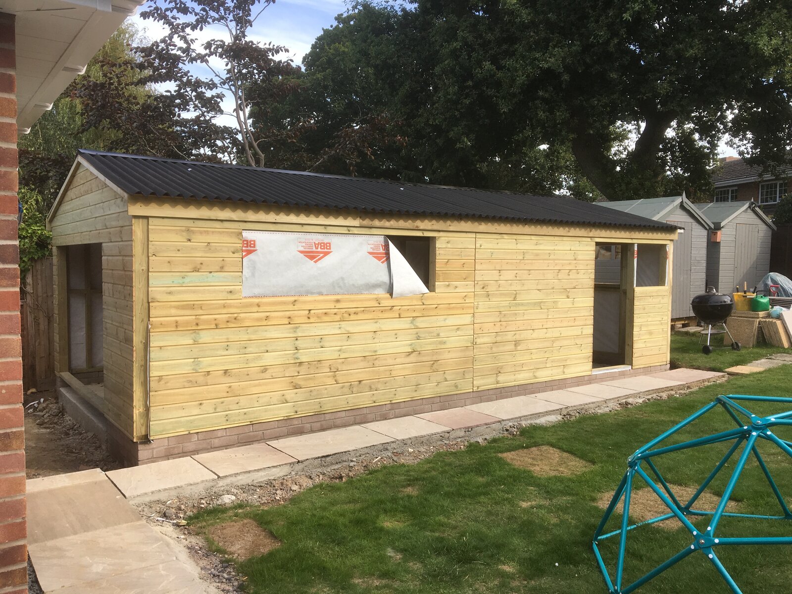

I have a similar size building and the timber is horizontal
I have horizontal shiplap, because the old vertical T&G all rotted at the bottom, and I've seen it before.
