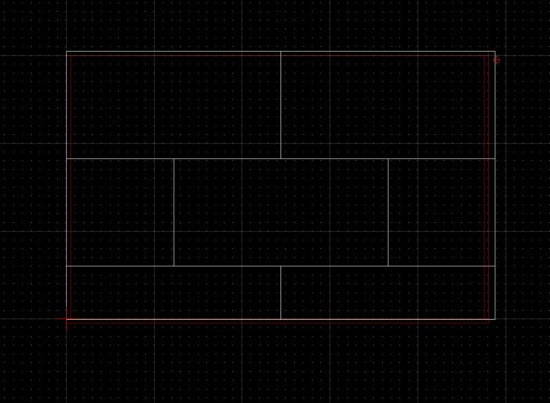

Hey all,
So I am building my first shed, and I am designing the flooring / joists and how they will fit together. From what I kind find on the market for joists... I only see 2.4m, 3m, 4.2m, 4.8m etc cuts. For this shed, I was thinking of using:
Pressure Treated Softwood Joist Timber - 47 x 150mm x 4.8m / 3.0m C24
I was thinking of making the shed 3m x 5m.
Thats fine so far... so then I look at Marine Plywood for the flooring. It only comes in 1220x2440 cuts. OK, so I draw how the Plywood will fit on various configurations of the joists.. and its SLIGHLTY off by a tiny fraction in each way I can think of.
I have two options.. cut the timber or buy an extra plywood.
If I cut the timber, I would have to "treat" the edges again, how hard is that? Is it easier to just get an extra plywood and use the extra to make a desk or shelves or something?

I guess since I don't want to risk cutting the joists and ruining the treatment (rotting joists is the worse thing..) I'll just get an extra sheet.
By the way, my next question would be about my slab. I have an existing slab with DPC that used to house a 3m x 3.6m shed. Basically, if I re-use it I would have my floor hanging off the side by 1.2m.
I have some rubble from a demolished brick extension, can I just put a DPC and then some of the bricks / rubble on top to support the "hanging" part? I am trying to avoid getting a new concrete slab because the back of my house has no access.. hard to get in.
