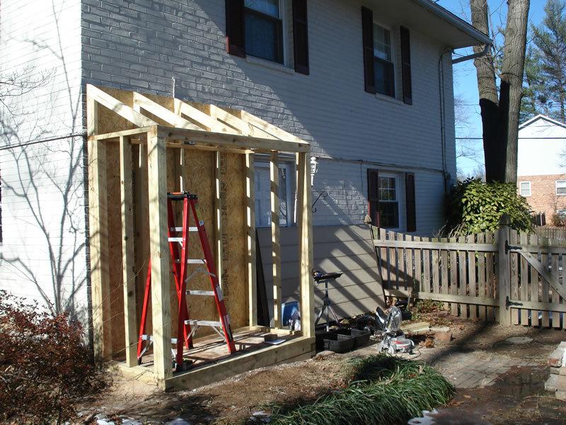

I would like to build a lean to shed and have a few (probably silly) questions I hope someone may be able to advise me on.
1. I am trying to decide between methods either
Method A. Essentially a deck with a lean to pergola over the top - cementing some fence posts into the ground and then screwing some form of cladding to the fence posts so essentially I would have something like this but with the 3 sides filled in and a suspended floor attached to the posts
Method B. create a base and them create a frame on 3 sides using 2x4 like this
The question is which method would be the best method to use ?
2. If I went for method B and built a complete frame on the inside would this need to be tantalised wood or could be internal CLS 2x4 since it will be internal
3. Finally what options do I have the outside wall coverings. I would like shiplap cladding but it is expensive are there any other good cheaper alternatives and if I did go with the cladding would this need to be tantalised treated if I am going to treat the wood afterwards

The kind of cladding that comes with a typical overlap shed is hardly the best, though if its in good nick and you can get it off without mashing it up then why not. Really though not using treated for the studs etc is gonna end in tears.
thanks Freddy I will go with pressure treated beams for the base and also pressure treated 2x3 for the side frames.
I'll have to look at the cost of the shiplap cladding again as I only priced it in B & Q and was going to work out quite expensive - I wonder if my local wood yard would sell shiplap ?
I'd personally go for option B.
But don't make a timber foundation, get some blocks to create a small up-stand to sit the frame on, significantly more durable option.

somewhat like this.......
It's a much more durable option to keep the timber above ground.
