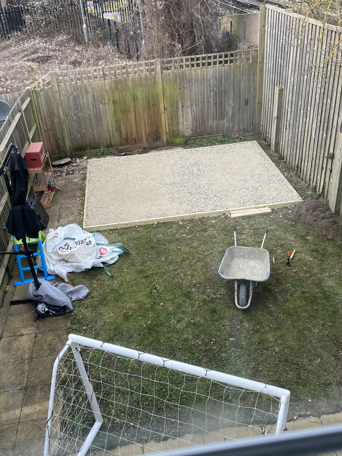

Good afternoon all,
I have a Mercia 4mx3m shed being delivered in a couple of days. I have dug down and put in a type 1 pad for the shed to sit on. It was compacted in stages and there’s around 4t used for the base itself.
Am I okay putting the shed on slabs to raise it? I have some wood that I could raise it on, however I am conscious of it rotting over time.
Many thanks
Provided the Type 1 is completely level you will have level slabs when you lay them. If not you may need to bed them on a sand/cement mix. You will need to ensure you have plenty slabs to spread the weight of the shed though or you may end up with the floor bouncing.
