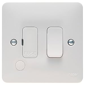

I have now seen a 3A switched spur which I can use to supply a light.
But there are much nicer looking ones available!you can also use that as the 'light switch', without having to have a separate switch. ... something like:
I'm not sure that aesthetics are much of an issue in a shed, but it's obviously a matter of personal taste - do I take it that you would regard this as 'nicer'? ...But there are much nicer looking ones available!
Slightly different, I suppose, fromhowever these, I would class as 'nicer' ...
