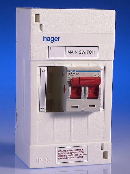

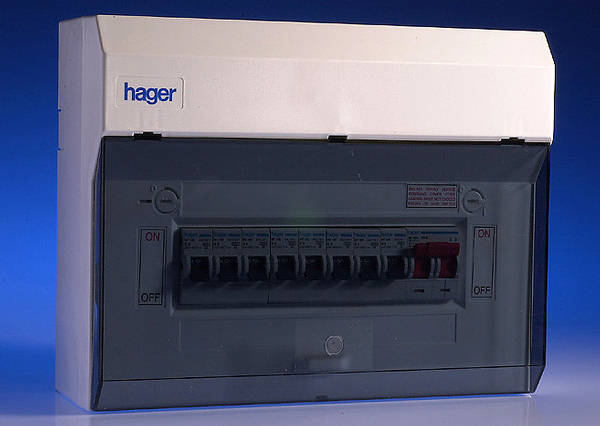

CUs come in any number of ways.
12 way:
8 way:
1 way:
14 way (but available up to 21 way)
6 or 8 way 3 phase board, adaptable to 18 or 24 way single phase:
with a 16 way 3 phase board, you could have up to 48 ways. ;)

Hope you like going about your life in the dark :p and I think you mean MCB's. You should only have the 1 RCD, or 2 if you have a TT supply.
Davy
Sorry, getting the jargon a bit wrong.
Basically the electrician recommended the same type of CU as the one in my home and the one I saw in B&Q with, I think, 10 MCBs. 5 with the
RCD and 5 without. So I was going to copy what I have at home and put
the sockets on the RCD ones and the lights (which I'm not rewiring as they're OK) on the non-RCD ones if I run out of RCD ones.
Looks like this Hager one:
http://en.wikipedia.org/wiki/Consumer_unit
It's always a better idea to put the lights on the non-rcd side (except for TT supplies) because you don't want to be plunged into darkness when it trips.
