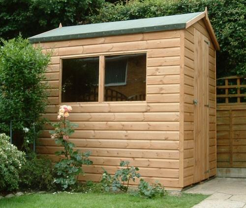

Have recently had garden landscape and a new shed and summer house installed.
Lately having problems with dampness and mould around wall/floor base.
Have put in dehumidifiers which are working but still had damp patches.
I am looking at install some sort of extractor fan and was after any ideas that maybe on the market.
Would like a plug in version so i can put on a plug in timer, but if needed can use a bathroom version (but can these be converted to a plug) or just wired into a fused switch so can be on all the time.
Any information or help would be appreciated.

the shed has a wooden floor onto a patio area. there is no guttering on the roof. the shed is not heated
OK, so the lack of guttering will make it damp. You could add guttering and a rain-butt fairly easily.
how deep is the gap between the patio and the wooden floor, and how well is it ventilated?
Got rain butt so guttering is easy to intsall, Gap between fllor and patio is about an inch
the picture shows what it looks like patio to shed floor from the front ( this is a google picture not actual shed)[/img]
the guttering will reduce the amount of water getting under the floor. Once installed have a look after rain and see if it is fairly dry or if there is a slope causing it to run under.
the gap under the floor is very small (it would be better if the bearers were raised on paving slabs or something to lift them above the damp) but if unobstructed, airflow will help ventilate it

will do the guttering and rain butt but dont know if i could raise the floor as it is a loaded shed and summer house and lifting couldd be a problem :(

Another thing which would have been much better, and which will also now be very hard to fix, would be for the shed not to be sat on the patio paving, as when it rains water will just run underneath it. Ideally shed bases should be no larger than the shed, and surrounded by a small trench filled with gravel* to reduce the changes of water splashing up onto the walls.
