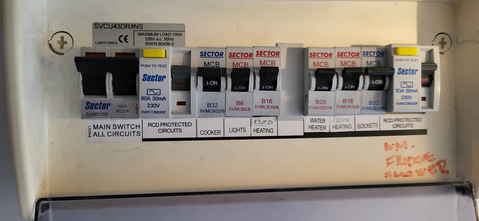

Hi.
I'm property maintenance for a landlord, and they'd like me to research their hot water immersion heater and whether it can be remotely controlled via their consumer unit (pictured).
EDIT: the property is a short stay air B&B holiday home.
I've found a Shelly 16amp, which is what most immersion heaters seem to be rated at, but I've read that these Shelly controllers don't last long on high-draw appliances, and that something needs to be added to stop that happening. This is the one I'm looking at...
Does anyone have any experience of installing and using these Shelly devices?

You could use a bog standard smart relay to drive a contactor which then switches the load, it'll need a little wiring and some kind of enclosure though.

Timeguard do a timed switch (2 hours in 30 minute segments and 1 hour in 15 mimnute segements iirc). That should solve the problem you describe, easy to swap over from the usual switch. I have had one in for ten years on an immersion heater without problem.
Boost function can either override the immersion heater timer for a set time, allowing the water to be heated in peak-tariff hours, or can override the CT coil so it heats the water when there is not enough solar, in both cases, there is a time limit.
40 gallons at 10ºC start and 75ºC finish will cost peak £4.30 off-peak £1.23 but unlikely the water would be at 10ºC at point of leaving AirB&B so in real terms it may save £2 and boost is likely not for 4 hours 34 minutes it would take to heat from cold, so a lot of messing around for very little gain. (working on 31.31p peak, 8.95p off peak)
