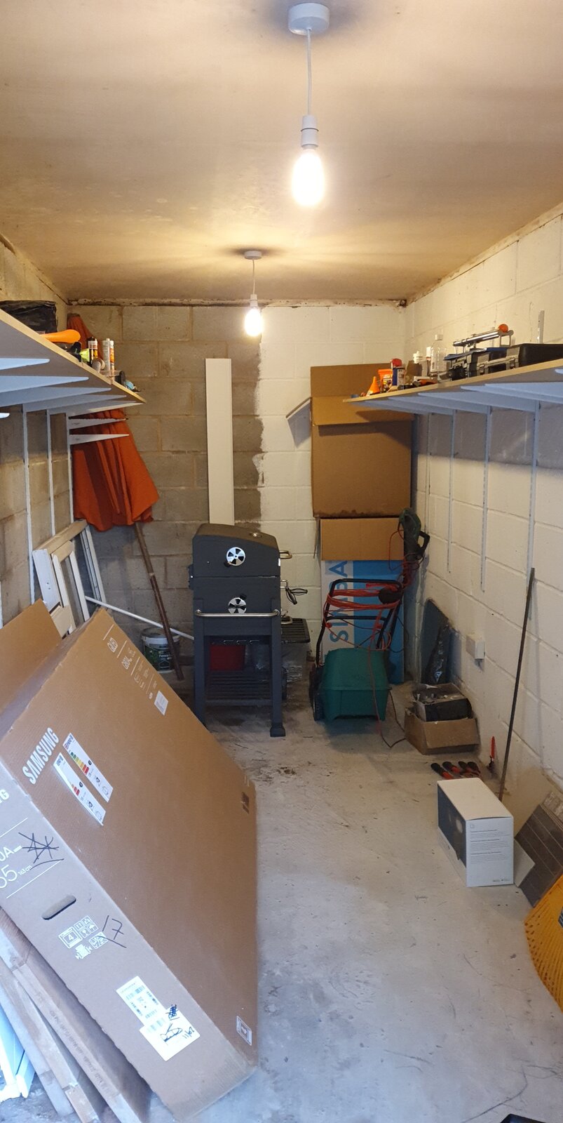

I'm looking for shelving material for my shed.
I currently have many slot brackets and just need the actual shelf.
When I moved in the wood was covered in mould. I've placed an air brick and bought new moisture resistant MDF sheets. These have also moulded really quickly.
I think it may be due to humditiy from keeping car towels and a jet wash in the shed.
Anyway. I'm looking for new shelving material that isn't wood. Maybe metal or plastic. Does anyone have an idea for some inexpensive shelving material that is non wood?
I was looking at roof metal sheets as they're cheap and stacking a few on top of each other.
I've attached a pic of the shed
Thanks in advance

Put something waterproof on the floor. Lift it up a week later. Is water coming up through the floor?
Are the gutters spilling?
You didn't mention how you ventilate this shed.
In most sheds the shelves have to support quite heavy loads, such as metal tools or tins of paint. Hence your shelves need to be strong. Despite your aversion to wood, if wooden shelves are thorougly primed and gloss-painted with oil-based paints they should be long-lasting and easily wiped down if they ever have surface mould on them.

Vent either end so air flows through will help lower humidity.
I lashed varnish over my builders planks as I store outside so they don't get damp and heavy. I just run paper towel over them if wet and been good for 10+ years with no rot.

The old way is to use block board as won't bow and finish edge with round quadrant which was used in shops for years as shelving. Could varnish or paint that to seal.
Reading your question im thinking cement board is what your after but how well that will work for shelving I can't say
Why not just put a cheap coat of oil based varnish on the MDF?
