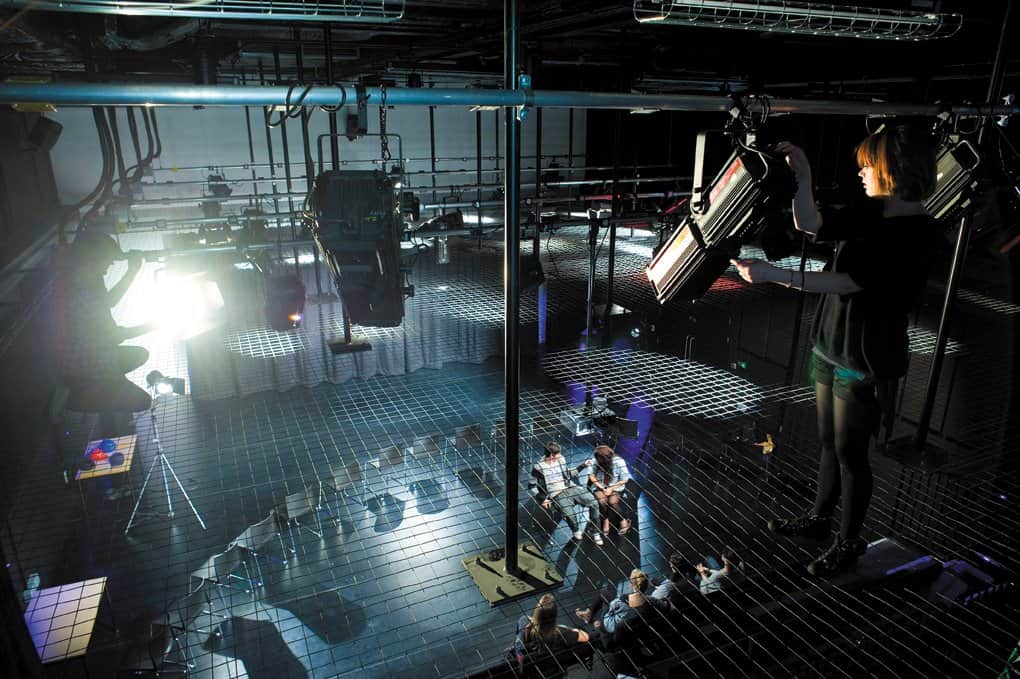

I plan to install CCTV cameras at home.
I came across a recommendation that a wire cage around the 'delicate' (lens) camera, to avoid the possibility of someone throwing something at it.
I am curious here. Wouldn't the wires interfere with a captured image?.

It should work so long as you can clean it. The lens should focus past the frame, making it invisible.
There's a technique called "pull focus" used in films where you can show a tiger, then adjust focus and reveal the bars of the cage. The camera needs to be on the longer end of the lens, not on a wide angle (common on cctv cameras

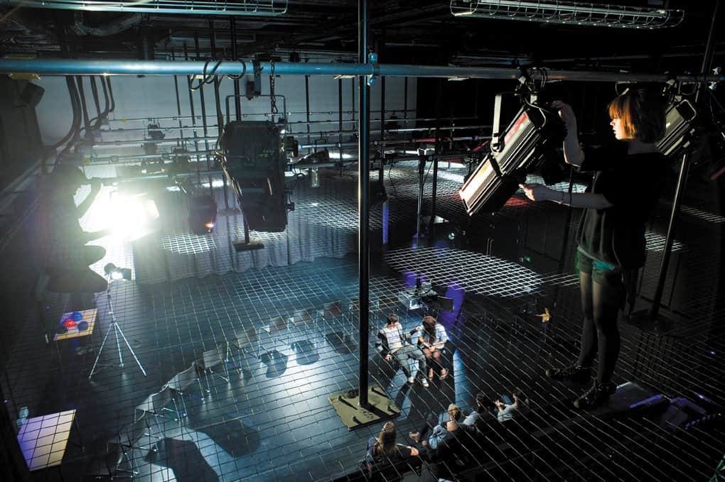

In theatre the conventional tallescope or ladder is being replaced by a tension wire grid. This is basically a 2" wire rope net under tension that you walk on. The lights are about 3 feet away from the mesh, and shine through the mesh..the mesh doesn't show because the lights are focused past the grid.

That is a tad extreme unless you live in a very very rough area. You do not need a cage just make sure the cameras are out of reach for the average sized human.
cages usually have openings so the person needs to be a crack shot to hit the camera and the IR bounce back wouldn't be an issue.
