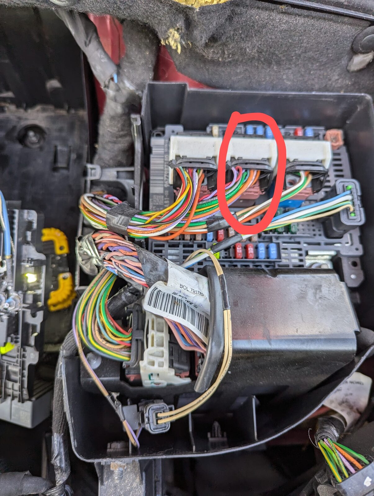

I have a Citroen C4 that is suddenly out of power completely (just like having a dead battery). The battery is checked to be still good and there is no blown fuse.
I did some tests with my multimeter and found that there was continuity between the positive terminal and negative terminal of the battery, meaning that there is at least one short circuit somewhere in the system.

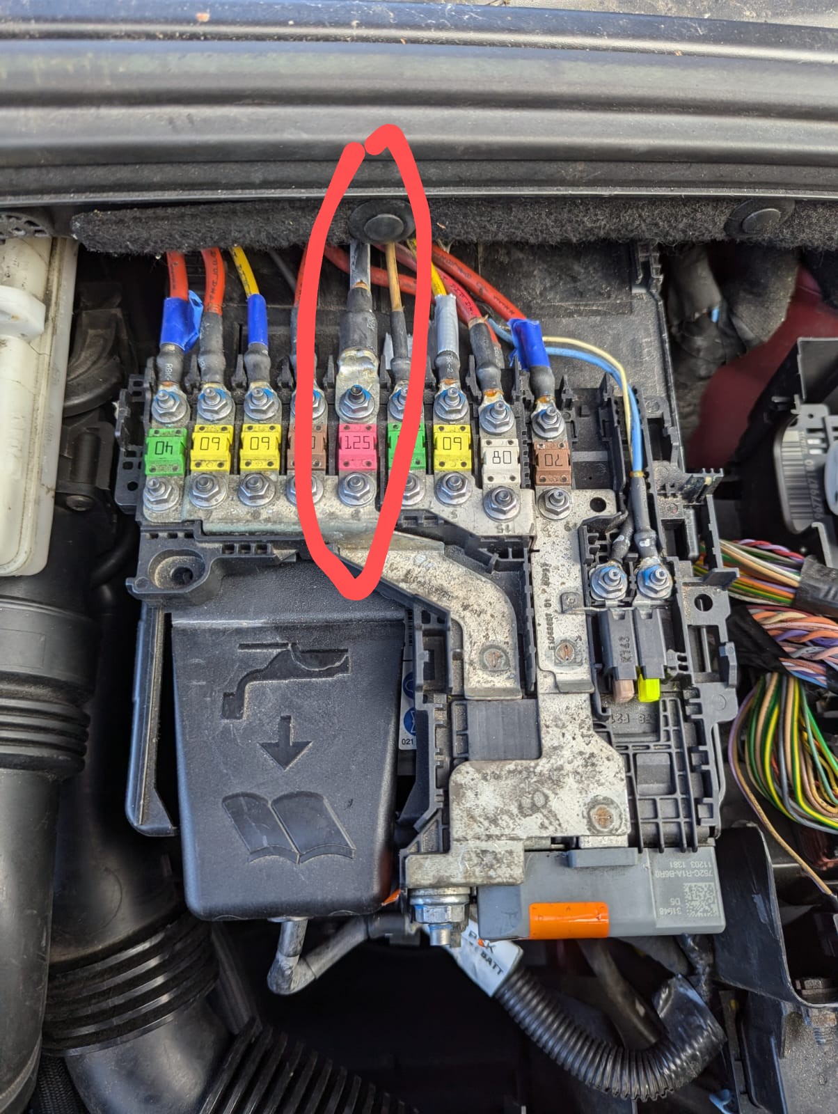

I tried pulling out fuses one by one trying to break the continuity, but was in vain until I disconnect a battery fuse (125Amps) which can be traced to a connector in the fuse box (see photo).
I tried looking up the user manual but there was no indication of what the connection or the fuse is for. I tried to locate the relevant system by turning on the car with that connector disconnected, but the electrical system by and large is still not functioning.
I have thought about buying a short circuit finder (like ECT300) to trace the location of short circuit, but with the huge bunch of wires associated with the connector, I am not sure whether it would work and not give false alarms here and there.
Have anyone had any experience in dealing with this before? Any thoughts are much appreciated. Thank you in advance.

Yes, I have the battery disconnected first before measuring the resistance between the two terminals. And the resistance was extremely low (reading was 0.05 on a 200 Ohm setting) until I disconnect the connector in the fuse box.

Yes I understand what you mean and sorry for the confusion. To provide more context, the resistance between the two terminals (with battery disconnected) was just 0.05 in a 200 Ohm setting, which seems a bit low. And after disconnecting the connector in the fuse box and putting back the battery in place, some of the electrical aspects such as dash lights come back on again, which previously have none. My theory was that the shorted circuit took all the current, rendering other functions failed. By disconnecting the shorted circuit, the current can now flow to various other parts, therefore some electrical features come back on. So that’s why I think there was a short circuit. I am all ears if there is anything wrong with my analysis.

Expect there to be a small electrical drain at all times - this is to enable the immobiliser, radio memory etc.
This is what I would do.......my multimeter is capable of reading 10 amps DC though.
Disconnect the battery positive terminal, and insert the meter between the battery post and the loose terminal. Any current draw will then be seen.....only a small current loss is acceptable, maybe one amp or so.
After that, investigate the condition of the thick lead going to the starter motor for fraying, tightness or corrosion etc.

But in my case, I think the drain of power from the battery is quite obvious. Before the electrical system suddenly broke down last week, I have been constantly running the car through motorway. As there have never been any warning lights regarding my battery, I assumed that the alternator was running ok and the battery was fully charged at all times.
One day, all of a sudden when I tried to start the car, there were a few weak cranks, followed by a completely dead electrical system (not only the car won’t start, but there was even no dash lights and all accessories such as window and central locking were not working). Several days later when I had time to work on the car and measured the voltage of the battery, there was only around 10v remaining, which was well below the normal 12.6v.
My theory was that there had been chronic issue with wiring, and the last time I tried to crank up the engine the wires just gave it completely and shorted itself out. When I disconnected the suspected culprit connector at the fuse box, some dash lights did come back up. So I am inclined to believe that there was a short circuit. I am eager to know what you think. Cheers.
To be honest Phil, if the short circuit was large there would be one hell of a spark when you reconnected the battery terminal......you'd both see it and hear it.
If you find a significant current drain, disconnect the alternator and see if the drain stops.
