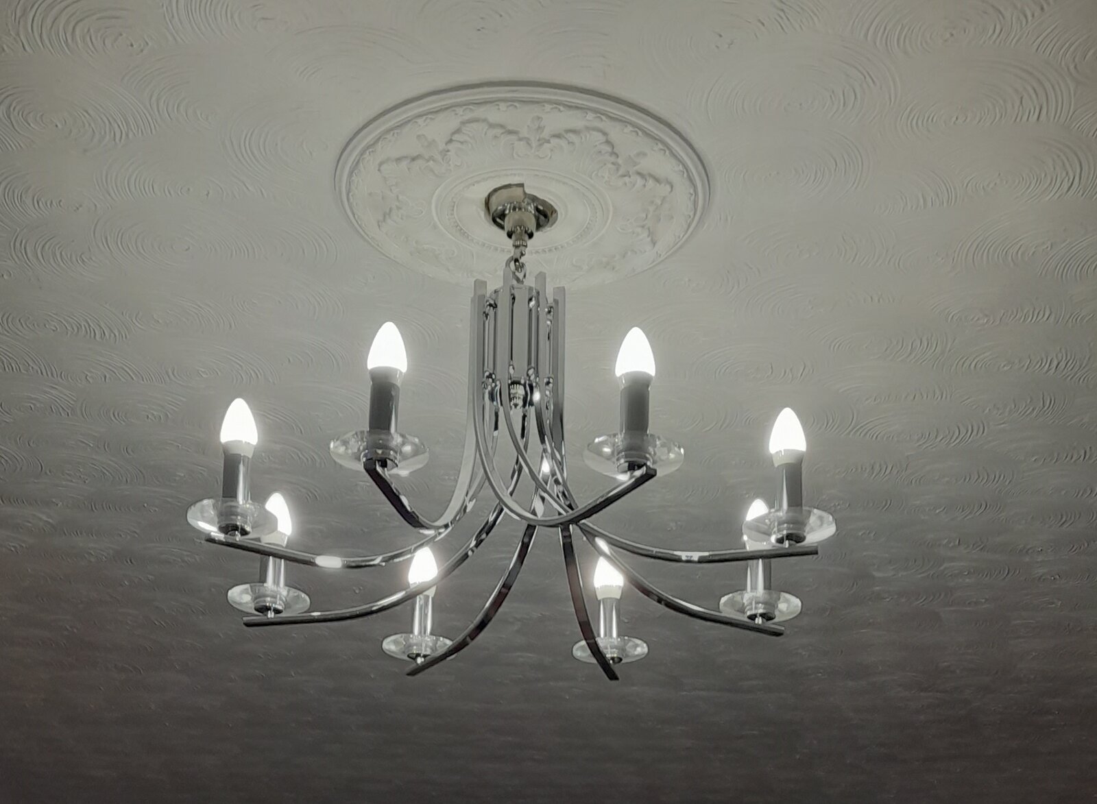

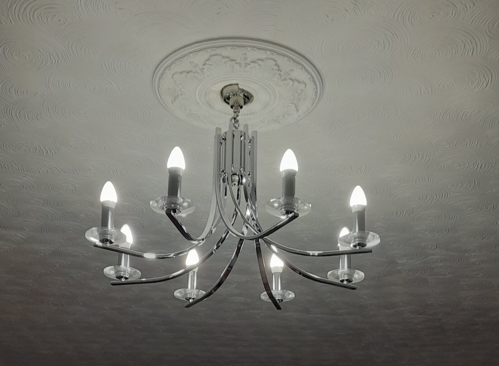

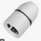

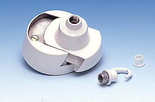

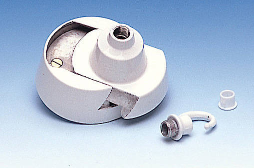

It depends on the rose, I find easier at the plug in part of the rose Ceiling rose.jpg as can be done on the floor. My chandelier would take some effort Ceiling light.jpg to reach the cable. But a simple bulb holder 1742743335646.pnglikely easier to do at the bulb holder.

A traditional UK pendant set is made up entirely from re-wirable components. You can shorten such a pendant set at either or both ends, or even replace the flex entirely.
I would however not be surprised at all to find some fancy pendants with non-rewirable lampholders.
I have indeed come across 2 of those recently, albeit stand lamp versions.
They took some serious effort and a large vice to be able to open them to replace the cable.
So I too would not be surprised to see non accessible pendant lamp holders.
