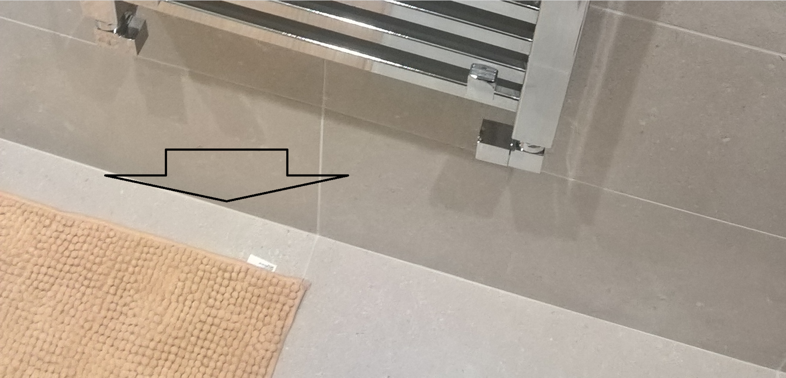

I had a new ensuite built two years ago. Two of the walls are from the original house and two were constructed of stud wall - we reorganised our bedroom to fit this in. The floor boards had plywood screwed to it and the walls and floor were then tiled. I've now noticed that where the stud wall meets the floor, there is a fine crack in the grout running all the way along this 90 degree corner.
The above picture is pre-crack.
Q. should I re-grout this or apply sealant? Is there a best practice and what product do you recommend?
Thanks in advance.

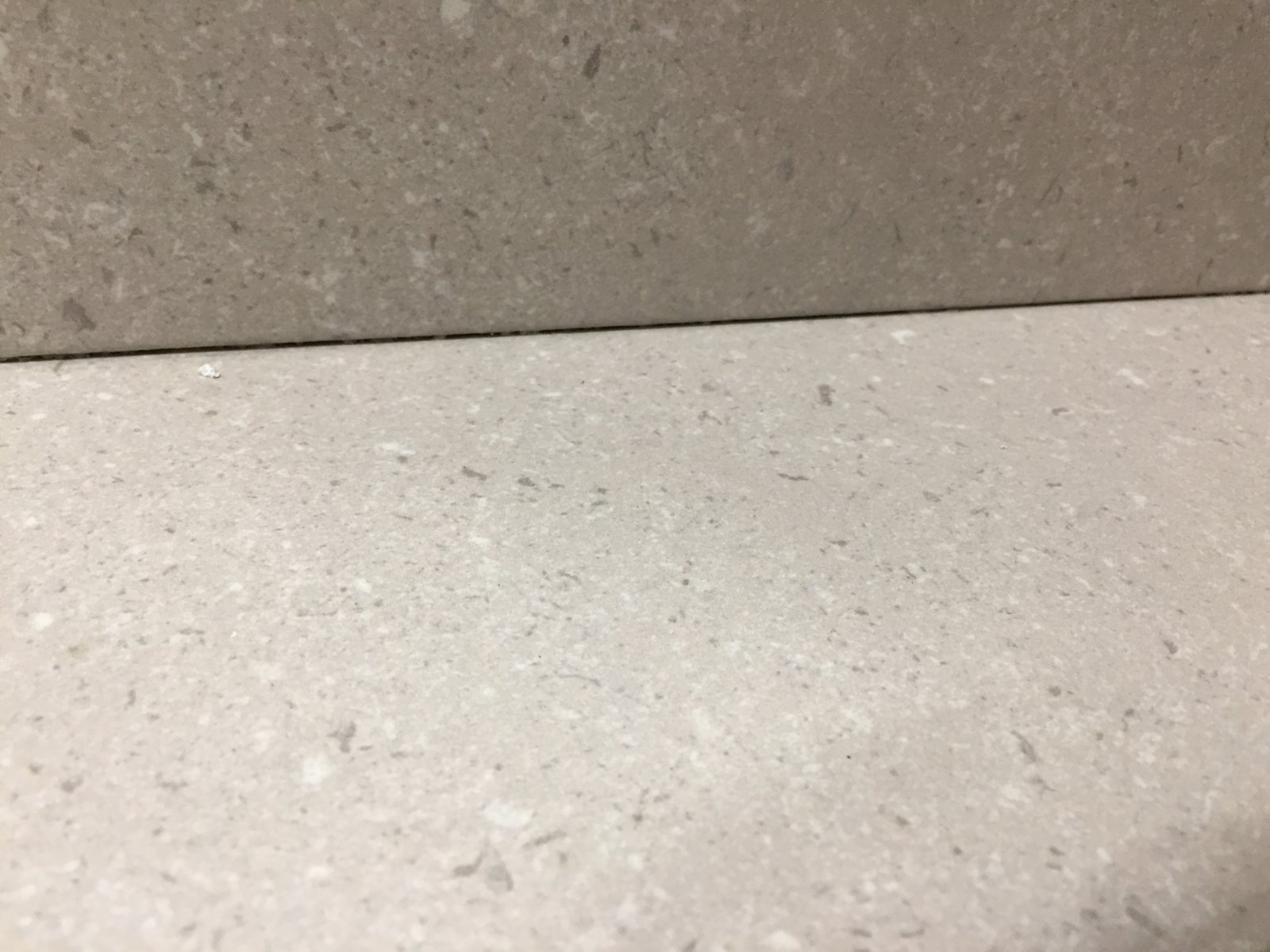

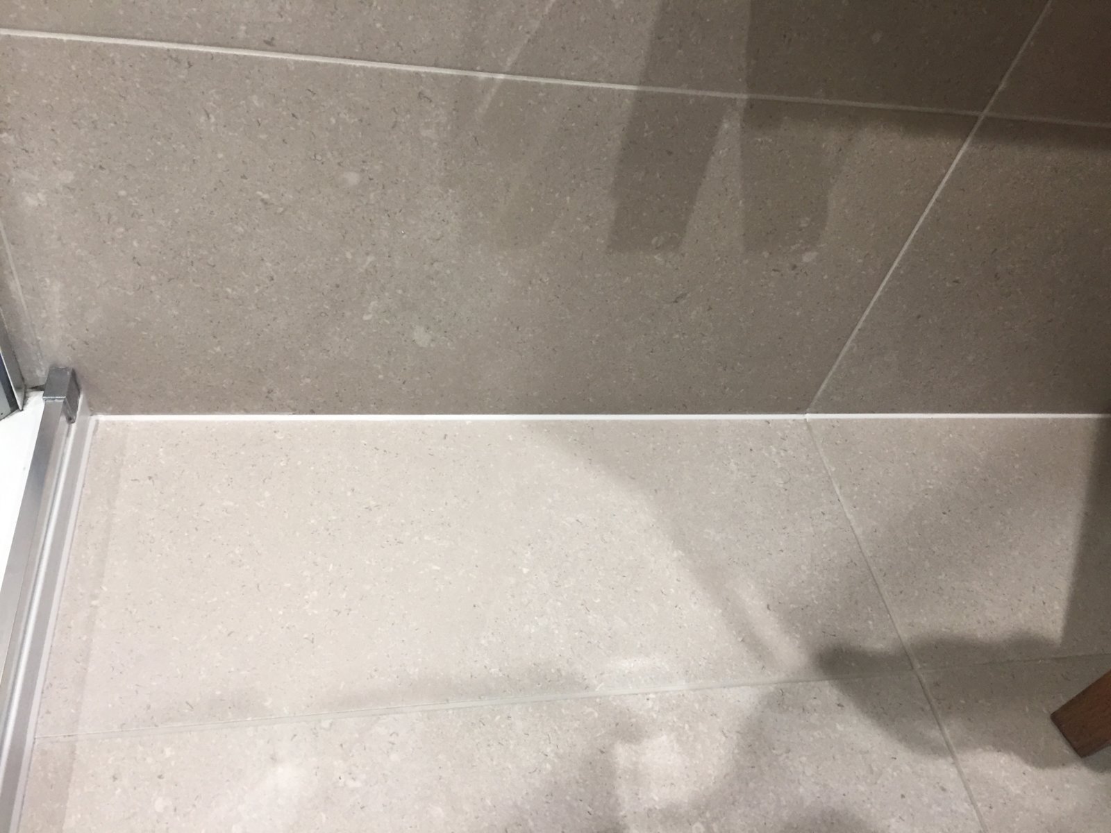

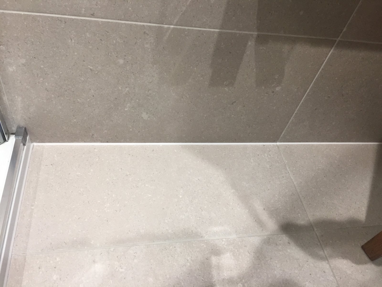

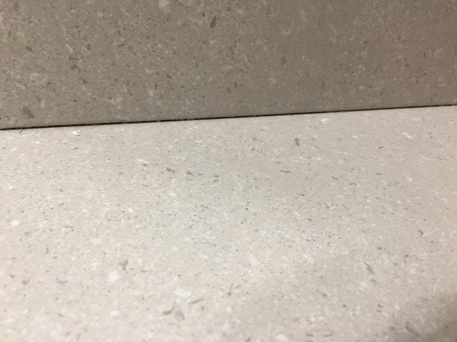

Did this today guys. Thanks for all your help.
