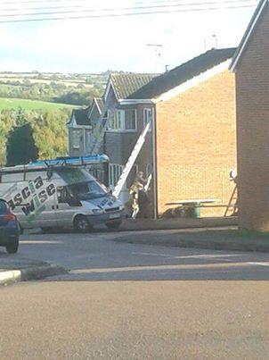

Hi, we are looking at having our gutters & fascias replaced. I have had a few quotes (All very different).
One company (Fascia Wise) have quoted us who seem quite cheap compared to others. But ive seen them working on a couple of houses on the estate and the use ladders not scaffold.
Ive been told it is my responsibility as the house owner to make sure anyone working on my house uses the correct safety/access equipment.
Does anyone know wants the correct way?
Ive added a photo.

As a homeowner you can be held responsible for the safety of people who work on your home as when you contract someone to do the work on your property you become the Employer or the 'Duty Holder' according to the HSE.
And as such you must ensure:
'All work at height is properly planned and organised;
Those involved in work at height are competent;
The risks from work at height are assessed and appropriate work equipment is selected and used;
The risks from fragile surfaces are properly controlled; and
equipment for work at height is properly inspected and maintained.'
The easiest way of ensuring the above is to ask to see the contractors Method Statement and Risk Assessment for the specific job in hand. If he produces these and you're happy with the proposed Methods then you can sleep easy.
If they have no idea about preparing Method Statements and Risk Assessments then the onus may be on you to ensure the job is planned properly and the risks assessed properly.

As a householder you are not expected to assume the responsibilities that a professional would.
You are appointing a company to do work on your property and have to rely on the contractor to comply with relevant legislation. There is a big difference between employing somebody and contracting the same people to do a specific job.
You will become liable if you insist on the work being carried out in a specific way.
With respect, how would you expect an average householder to be able to understand the implications of a method statement or risk assessment when they have no knowledge of the process?
If things go wrong and it all goes to court then as always common sense should prevail, so homeowners would not be penalised if they acted reasonably and in good faith.

So if the homeowner feels confident that they have acted reasonably to prevent an accident on their property then they won't have a problem. But if you have had 3 quotes from contractors and 2 are including scaffold, then it could be easily argued that it would have been reasonable for you to ask the 3rd guy why he wasn't providing scaffold - it may be that he has assessed the risks properly and has a wonderful safe method that the others hadn't thought of, but it would have been reasonable of you to enquire further.
In summary - if it looks dodgy it probably is, and if you are aware that it looks dodgy and allow it to go ahead and an accident occurs, then you could be held held accountable. I strongly believe homeowners should be aware of this as it will deter cowboy building practices and deter reckless customers, and ultimately save lives and legitimate businesses!
