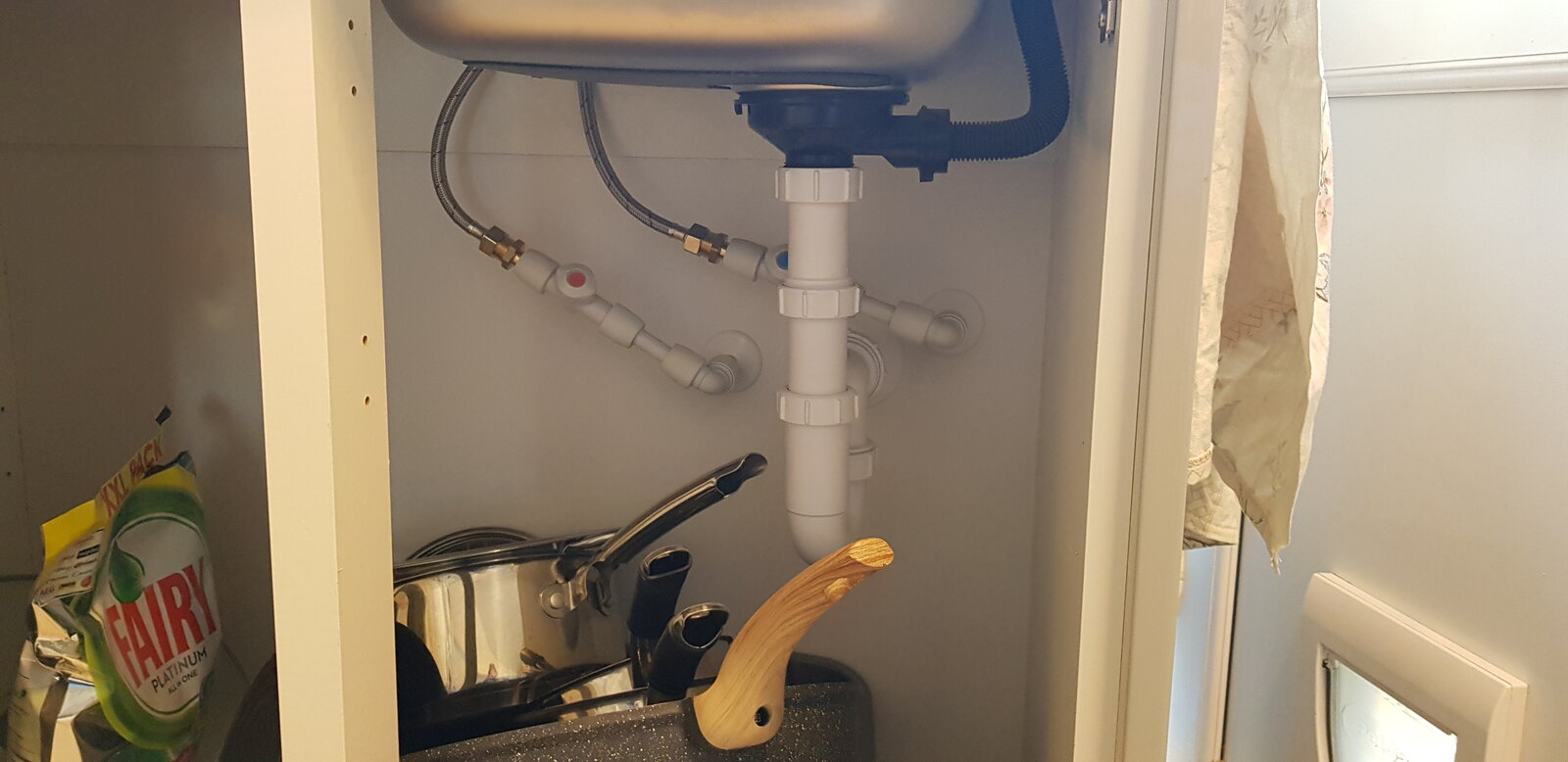

To reinforce the worktop you can use a 2x2 at the back screwed into the worktop.
At the front a carefully planned kitchen will see a post in the middle of sink opening and doors to fit.
Picture shows an 800 sink and the pillar at 400 so to accommodate a 400 door.
