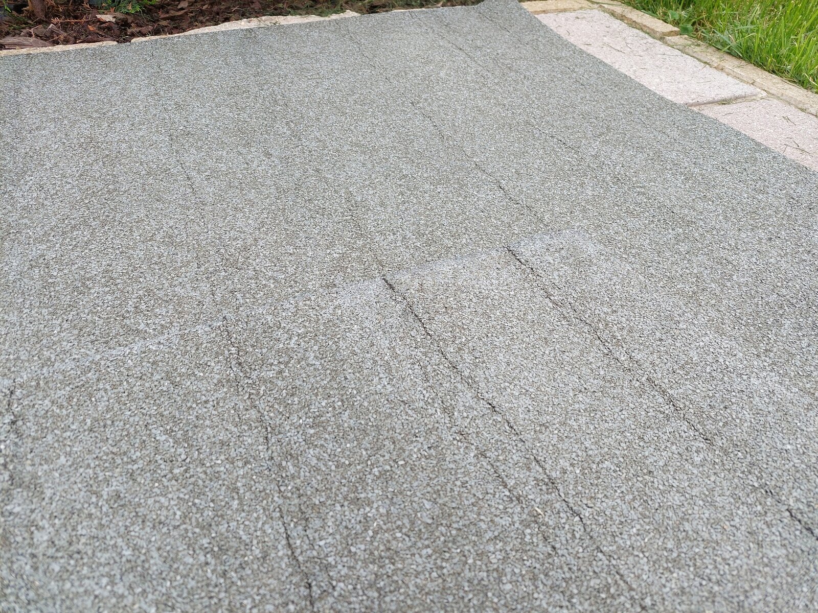

Should I install felt with crack lines?
4 Sep 2021
Hi, I bought a shed that came with felt that needs to be installed. A couple of months have passed since I received it and the felt has been sitting in the garden flat. Finally got to installing the felt but I notice it has quite a number of crack lines and I was wondering if it's worth installing as is or if it's better to buy a new one (it's £30). My plan is install a green roof on top of it so I want something solid that lasts.
Any advice welcomed, thank you.
Does it rip easily? Felt supplied with sheds is often cheap rubbish so if it does then whatever you're going to do, chuck it and get some decent stuff!
