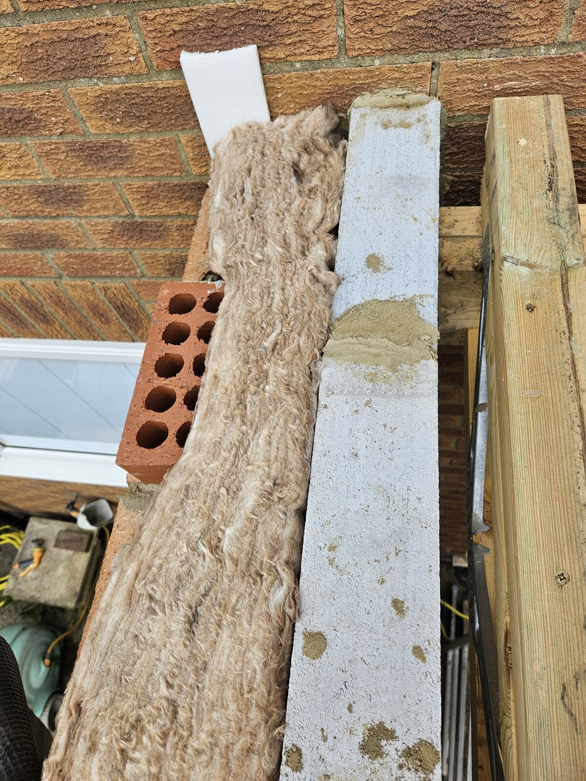

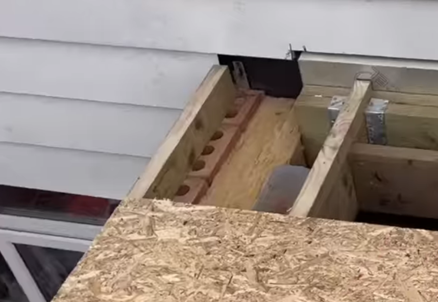

I'm doing a flat roof (brick and block cavity walls) and I'm reaching what is potentially the final course of bricks. I was planning to cut the last course of bricks at angles and then fix the OSB deck to them. I've realized that this will take a long time. I'm wondering whether I should use a timber firring for the last course instead? It'll be much easier and also make it easier to screw the OSB into.
The big drawback of timber is that it would increase the height of my fascia by 75+mm. That would leave me with 291 to cover with the fascia. So I would need to go with 400mm fascia instead of 250mm. I'm wondering whether cutting the bricks is a fools errand though. Should I just cut the bricks and stop worrying or is timber a better approach?
It would be very similar to what is in this video

I've covered it up for the evening now but it looks pretty much identical to the video but without the timber on the outer skin. Here's a picture from the video . My inner skin and insulation is also a bit higher than in the video/picture.

Here's a picture. Engineering brick is only there to push the insulation out of the way so that you can see the brickwork clearer. On the right, it's a firring strip on a metal web joist. The brickwork is currently lower by approx 75-125mm.

It would be good to hear about your much simpler way. I've posted a photo above. I don't know whether that shows you what you need.

I think I'm going to spend the time and cut the bricks as anything other than bricks will require a taller fascia. I'll probably use some masonry screws to screw the timber to the bricks.
I'm struggling to think of something that is simpler than cutting a piece of wood and gluing it.

Normally, the outer joist would be fitted with noggins to the joist on the inner face of the wall, and then the noggins packed up or built in to the outer leaf to support it.
