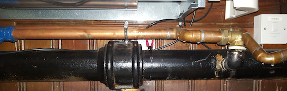

Doing a few odd jobs at church* today, one of them being to investigate a leak in one of the heaters. Anyway, I found the wiring to be a little "interesting" :whistle:
* Where I am now (thanks to being too slow to say no) on the PCC and the H&S person.
These heaters are basic fan coils plumbed into the old heating system, and controlled by stats on the pipes (so they come on when the water is hot, and go off when it's gone cold). AFAIK they were fitted a few years ago.
One of them gets little or no flow from the main system pump, so it's got it's own pump activated by it's own pipe stat. However I personally wouldn't class this as "suitably protected by placing out of reach", nor would I rate the strain relief very highly :
This is the pipe stat - complete with exposed (at least for little fingers) live parts.
And for context, here it is underneath the heater
So that's defect number one. Only one of the heaters has this exposed thermal switch, they all have another one but that's on an internal pipe and I'd say is well enough out of reach unless you take the cover off.

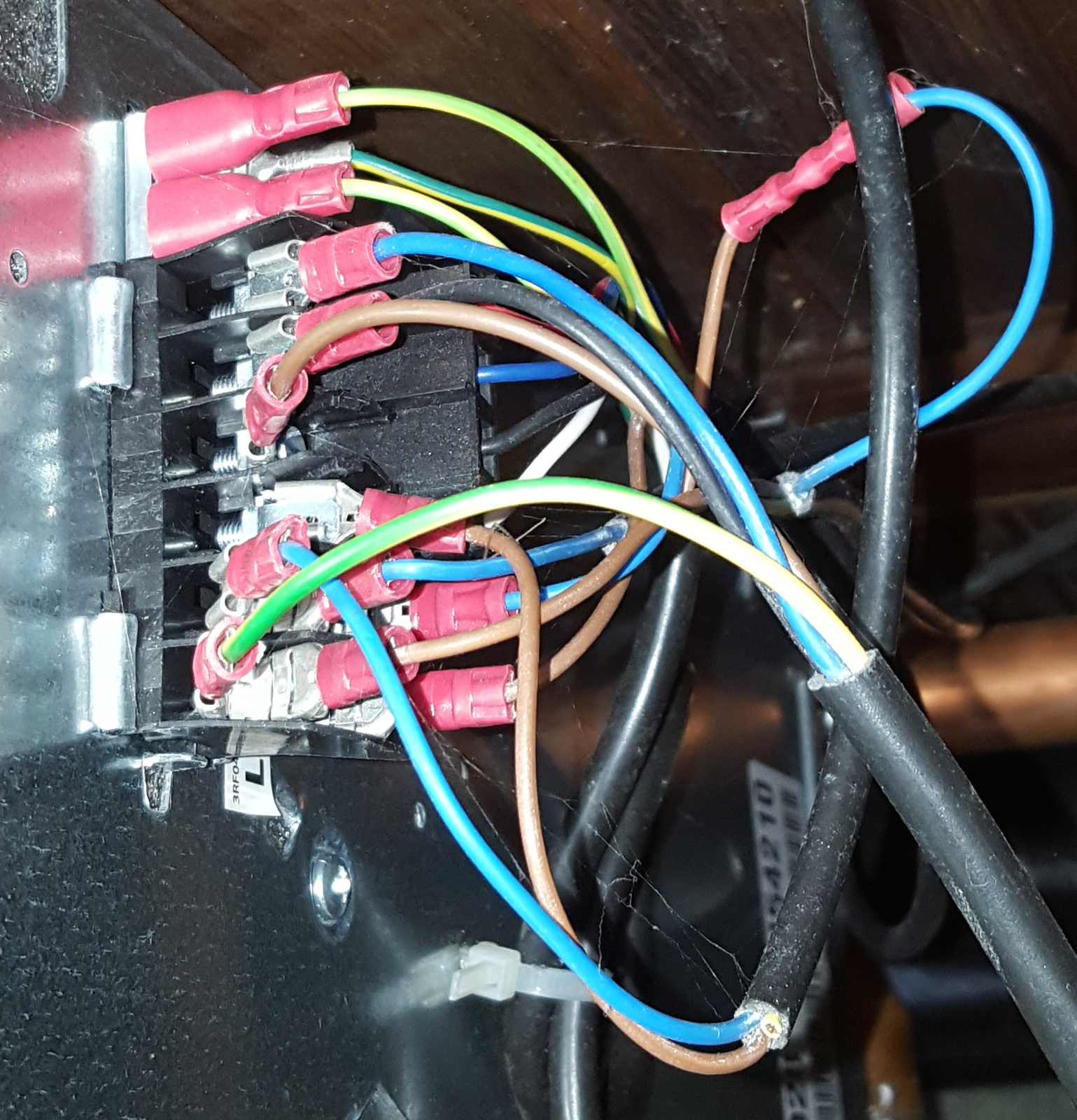

Then we revisit the "can you use a green/yellow core for something else" question :
There's a 3 speed switch for the fan, and they've used a bit of 4 core (3core + earth) flex for it - using the brown, blue, black cores for the 3 fan speeds, and the green/yellow core for the live feed :eek:
For good measure, see how they've snipped the earth core off that other cable ? It's going to one of the pipe stats, so they've snipped off the earth core at both ends - personally I'd have connected it at the terminal block just so that there isn't a cable with an unearthed earth core.

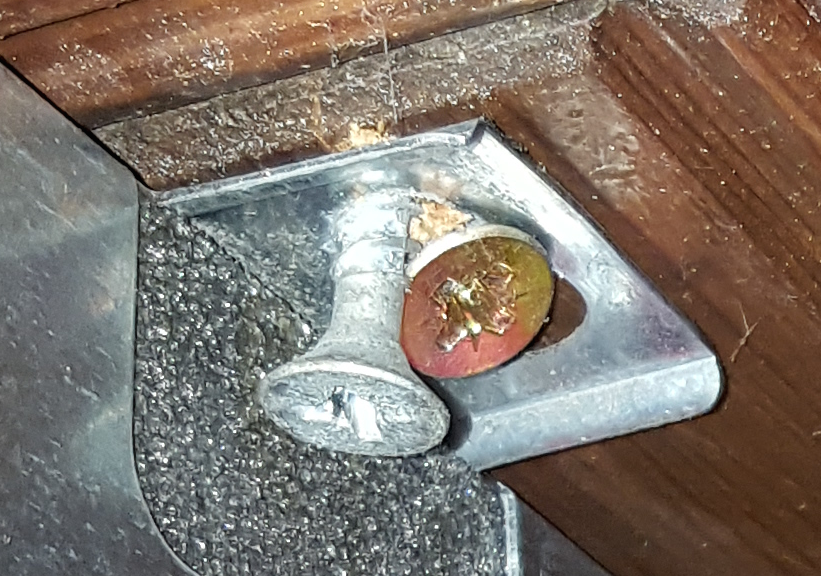

Here's the back of the switch :
Reckon that switch (with metal toggle and fixing) is DI ?
I haven't checked the other heaters, but I assume they are the same.
And for good measure, I think this about sums up the workmanship (the pluming is similarly "neat and tidy") :
So I make the tally :
  • Exposed live parts
  • Lack of strain relief
  • Use of earth core for live feed
  • Unearthed exposed metallic parts
  • Earth core in cable that isn't earthed at source end
Agree ? Disagree ? CBA ?
No neutral ?!
Kind Regards, John
This is the switch wiring - should be a bit clearer now I've got the images included. I put them in originally, honest !
The supply goes to two terminals on the block, a live goes up the flex to the internal pipe stat and back to another terminal, then from there it goes up the flex to the speed switch, and then three feeds (one per fan speed) come back to the wiring block. The fan itself is sired from those three terminals with it's own connection to the neutral terminal.
Similarly, a feed goes from the live terminal on the block, down the flex to the pipe stat underneath, then back up the flex where it's joined to another flex that goes to the pump, with the pump having it's own neutral connection on the wiring block.
They aren't oversleeved, so they must be cpcs.
You aren't suggesting, surely, that the people who did it are criminals? Because they would be if they didn't oversleeve.
