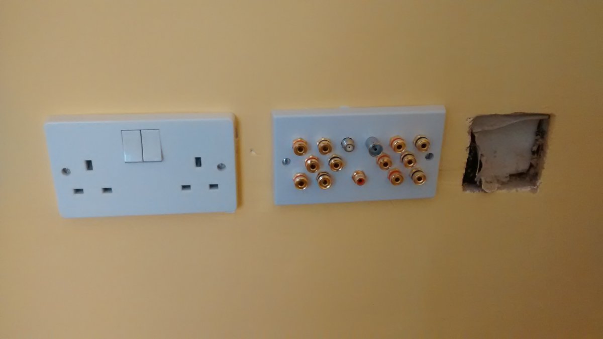

Im adding a couple more wall sockets, but getting a sparky to do it. Im also running ethernet cable with a few of sockets around the room for smart TV/PS4/Sky etc. Im also going to run some spare lengths of cable under the floorboards so if I need to run additional cables I can pull them through.
Glad to hear it about cables. It looks as if I am only slightly ahead of you plastering just done as I have just this moment returned from buying Ethernet plates sockets to go in wall (spot the empty hole). Much to my upset I did not manage to save my skirting so fitting new (ugh) skirting is next job.
