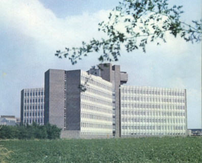

Rooms need 10 to 80 lumen per square foot, so my living room, 22 x 16 needs between 2 minimum to around 10 bulbs, as 50 watt down lights more like 16, this would be 800 watt, of which around 100 used for light, and not talking about fully heating the room with the lights, although that's what was done with this 1670665337184.png building the MANWEB headquarters in Chester but just allow the back ground temperature to be lowered, so ventilation will cost less, use of heat recovery units may reduce the cost of ventilation, but we can't simply spray expanding foam into all the air bricks, although often that is what happens with cavity wall insulation.

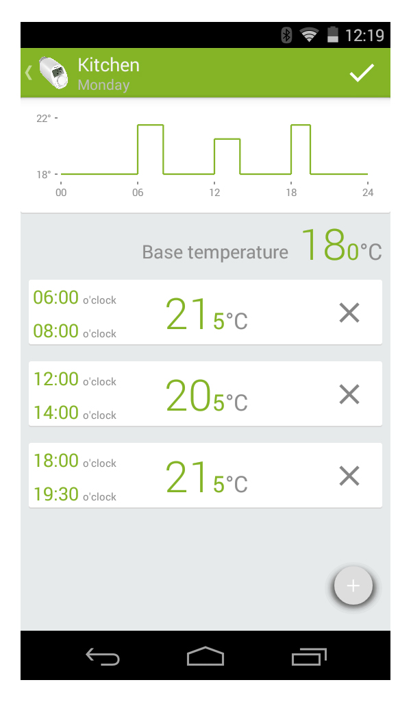

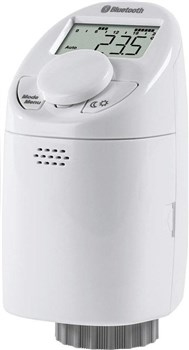

However what I am saying is one can use a mixture to heating methods, I have these EQ-3 Bluetooth Smart Radiator Thermostat.jpgTRV's and the left button changes it from Eco to Comfort and back, so as one walks into the room you can press the button to increase the temperature, but it takes time to lift the room by 2ºC, where the infrared is nearly instant, but much depends on the life style of the people living in the home, with retired people it is likely under floor heating would work, specially where no gas or oil, so need to use heat pumps, but where the occupants are at work all day, it would only work to give a back ground heat, you want to allow the home to cool while not occupied.
