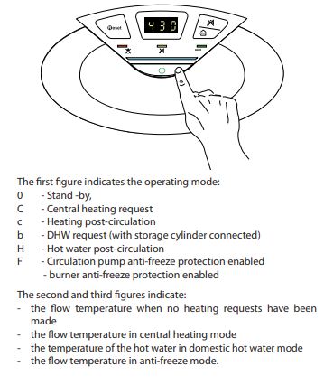

I recently moved into a house with an Ariston Clas HE boiler, external programmer (Honeywell DT90E) and room thermostat. The timer built into the boiler is bypassed (set to '1') so the external programmer has full control. In this condition, the boiler is 'active' all the time, 24 hours a day. When the programmer sets the heating off, hot water continues to recirculate and the boiler fires up occasionally to keep it at temperature. When the heating is on, everything works as expected. I tried setting the built-in timer and noted that the boiler is completely inactive when this is set to turn the heating off, which is what I would expect.

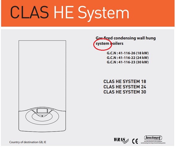

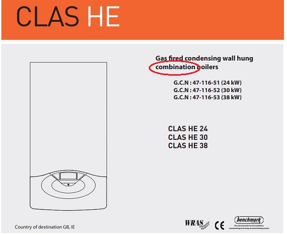

Can you confirm which type of boiler you have? [Clas HE comes as a heat only and a combi] What does the hot water channel of the ST9400C actually control? Do you have a thermal store?
You may also get a clue as to what's happening from the display, when it's running and you don't think it should be.
Thanks for chipping in. Although it doesn't explicitly say whether it's a combi or not anywhere, neither in the manual nor on the boiler itself, here is a cylinder (Ariston Primo ITI 210) with a built-in immersion heater (which I have never turned on), which I assumed was just for DHW. When the heating is off the display shows a lower case 'c' and the water temperature (e.g. c039), which I understand means it is in bypass mode. It does behave normally if switch off the programmer and use the internal time clock (although this doesn't keep time correctly so I can't leave it configured that way).

A combi boiler will fire up and heat the hot water on demand as soon as a hot tap is opened, so it's quite east to test. (make sure the central heating is switched off at the time of the test). However, now you have told us you have a hot water cylinder, it is extremely unlikely to be a combi. (the electric immersion heater in the cylinder is usually just there as an emergency back up).
As you have the installation manual (provided that it is the one that was supplied with the boiler, and not one you have found online) it tells you on the cover which version you have.
If you turn the boiler's integral timeswitch 'off', can you use the external controls to work the central heating, or does nothing happen?

Ok, the manual says system boiler, so I can confirm that it's not a combi.

Ok, I get that, but I was comparing it to how it works when I run the boiler with the built-in timeswitch. If I program the built-in timeswitch and force the programmer to heating 'on', it's as if I had just the room thermostat connected. In that case the boiler comes on when the timeswitch is 'on' and heats when the thermostat calls for it. When the timeswitch is on and the thermostat is off, the boiler goes into 'c' mode (heating post circulation) and when the timer is off the boiler is off (standby).
When the built-in timeswitch is off, nothing will get the boiler out of standby, so to use the external programmer I have to set the timeswitch to '1', i.e. on all the time. Then, as you say, I have heating when both the programmer and thermostat are on, but when either (or both) turn off, it always returns to heating post circulation and stays there until the next request. My original question was really because this behaviour is completely different from that of the built-in timeswitch. Turning the hot water programming off has no effect on this behaviour and if I leave it off I still have hot water the next day.
