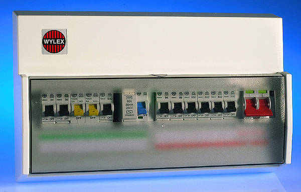

As Breezer says.... a new split load CU is relatively inexpensive these days.
£34.50 + VAT will get you this and that includes the RCD and Main Switch + the cost of the MCBs (£4.50 = VAT)
Please enlighten me breezer, how does a split c/u actually work ? Are some covered by the rcd and the other side not ? Love to know.
Yes .... you can usually determine which circuits you like to be covered by the RCD eg. Ring mains, cooker, outside sockets, shower etc. and you would tend to have the lighting, possibly Central Heating, bell transformer or whatever not covered by the RCD.
Some Split Load CU's are predetermined ie 5 from RCD and 5 from main switch whereas others can be shuffled about to suit yourself
