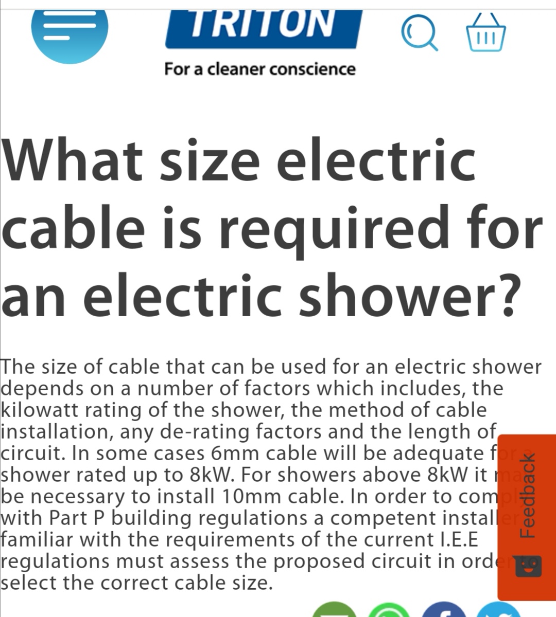

You've not seen a 10.5kw shower?! Don't know where you have been then...
I think the only nonsense was from yourself stating 6mm is fine for a 10.5kw shower??!
It wasn't nonsense as I indicated with the figures (as did EFLI)
That's not what I said. I've seen umpteen 10.5 kW showers, but I have never seen one which was "10.5 kw at 230V" - they invariably quote what the power would be at 240V (which corresponds to about 9.6 kW at 230V), but our design calculations are based on 230V
