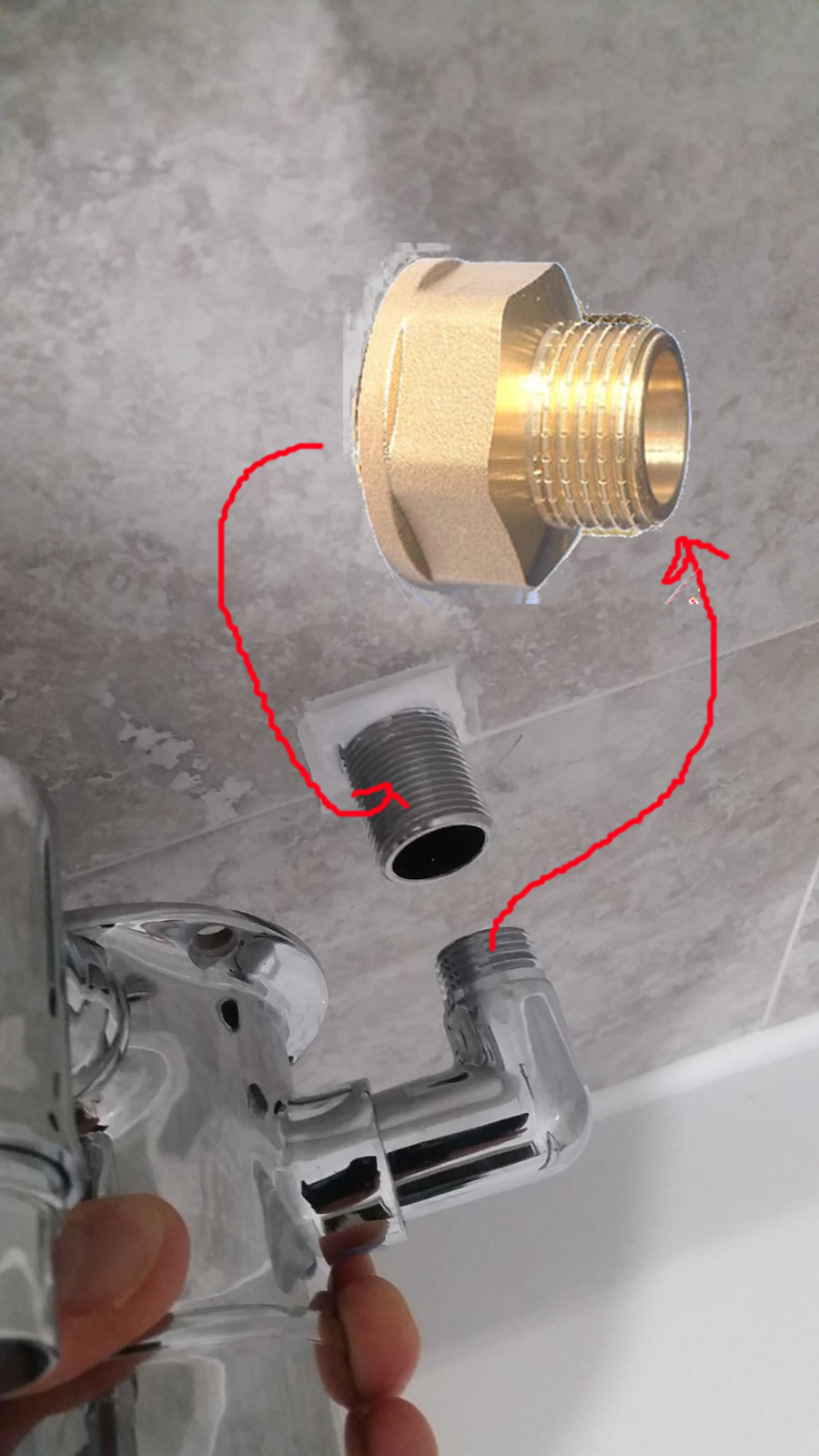

I have installed my bathroom and I was ready to hook up a new shower but it wont fit.
I have one of these built into the wall and tiled over - it is a bar valve fixing kit with 1" BSP threads that was supposed to save me time o_O
The shower my Mrs ended up getting is designed to fit a 15mm pipe through a compression joint rendering my bar valve fixing kit useless. I have also looked at a number of other showers and a lot of these seem to fit 3/4" BSP threads not 1" so the kit I have really is useless.
Here the issue in all its glory...
The only thing I can think of doing at the moment is getting a 1" female to 3/4" male reducing fitting. To do that I will need to grind back the 1" stub a bit which is risky as it might mess the thread up, and then i will be left with 2 x 3/4" males - how can i connect these so they wont leak?
I would really appreciate any advice, I am sure there is a much better way of sorting this which hopefully wont involve ripping everything out.

Don't forget BSP threads are measured from the inside diameter of the pipe, not the external diameter over the threads. Although the outside diameter of the threads sticking out from the wall may measure approximately 1", they are actually called 3/4" BSP, or G3/4 as noted in the Screwfix installation instructions.
I suspect the only way you are going to sort this out is by taking the tiles off and replacing the fixing plate with a more suitable set up.

Cheers for the replies. My bad - agreed these are 3/4".
I suspect the tiles are coming off one way or another. Don't fancy bodging it and even if i can connect everything up, the shower bar will be miles off the wall.

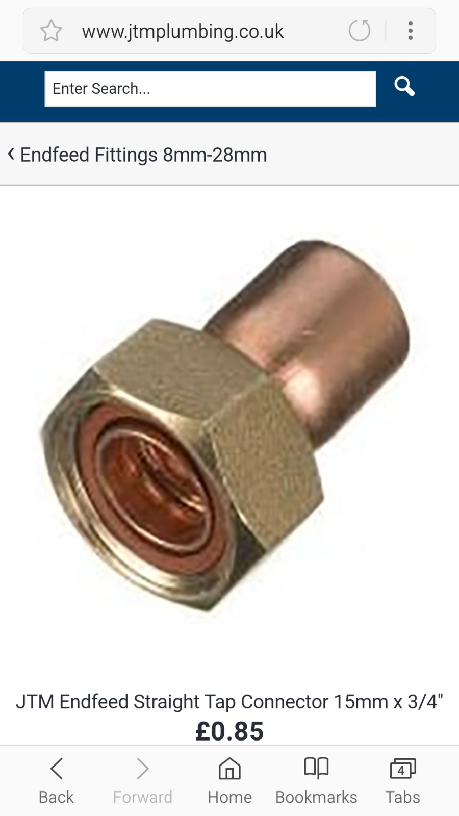

Could you use a couple of these and the 15mm compression fittings on the end?.
