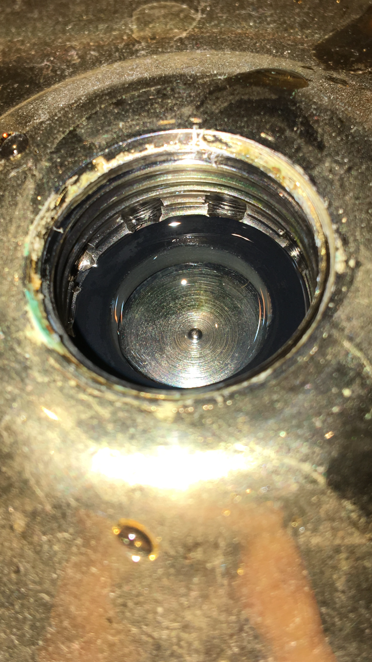

Ive got a combi boiler and a thermostatic shower in my loft which has been working fine but recently when I turn it on it runs and as i turn it to full power it makes a Clunk noise and then cuts the water off. Only thing that has changed is that since it has been installed we have now started using the heating. I tried running it cold though and the same thing happened. If I run the handheld shower jet attachment that runs fine and they run together fine but when its just the big overhead rain shower bit it cuts out. Also if i turn it up very very slowly I can get to nearly full power before it cuts out, if i turn it quickly it cuts out on only a quarter turn.

Yep, looks like the shower head is the culprit, if it’s fully screwed onto the arm it blocks the holes the water runs through, if it’s half screwed on the water can flow out. For some reason the outlet holes are in the screw thread! Bizarre
What a crazy design !! At least you sussed it. Any chance of a pic ,I am intrigued !!
Is that a rubber O ring seal in the bottom ? If it is then surely it must be tightened down to compress the seal ,so water will not escape around the threads ? It maybe that the problem is elsewhere and by loosening the head you are making enough of a difference in the resistance to allow it to work. I would get the Installer back .
The only way out for the water is through the threads, the installer said he hadn’t come across anything like it and suggested not fully tightening but surely there’s something missing?
If the shower arm has a flange at the top of the thread, move the o ring on to the shower arm thread. It will then compress between flange & head to provide seal and allow a bit more room beneath the end of the arm for water to flow. Alternatively throw o ring away and assemble with ptfe tape screwing on 2 or 3 turns.
